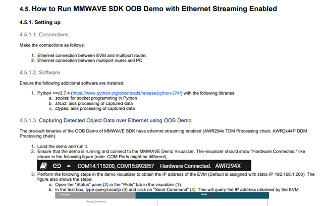

  • Hi Emil,
    Can you confirm if you are following all the steps mentioned in section 4.5 of the user guide? sharing a snippet here for your reference:
    also, please check your hardware setup as well.
