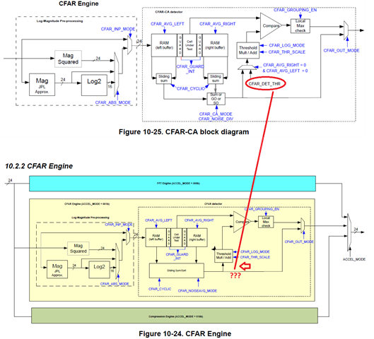

In AWRL1432 TRM version C, Figure 10-25 has CFAR_DET_THR but Figure 10-24 doesn't have CFAR_DET_THR.
Which one is correct?
Does AWRL1432 have CFAR_DET_THR in CFAR engine?
Hi, James:
Good catch! Yes, AWRL1432 do have CFAR_DET_THR in CFAR engine. That is the basic function for CFAR.
Zigang
