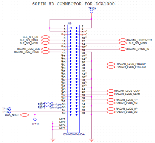

SPI (x5)/ RS232 (x2)/ RESET (x1)/ LVDS (x4) / LVDS CLK (x4)
I am using the above signals on the custom board.

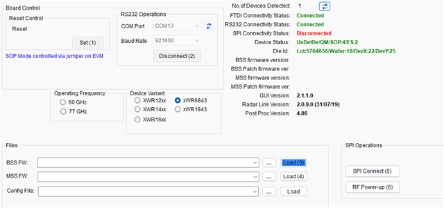

However, SPI is displayed as disconnected.

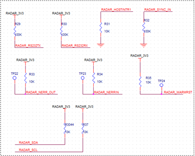

    Can you please check if the pull ups are given correctly. Can you share a snap of the setup which you are using.
    Sreedeep
    Please tell me which pull-up to check.
    Firstly, as above, the difference is that there is no SPI CS pull-up. (This is because it is communicating with the MCU [slave] and has an internal pull-up.)

    The signals on the custom board connected via the DCA1000 are identical to those in the attached photograph of the written post.
    [GUI]
    The AWR6843ISK and DCA1000 have been successfully connected. When attempting to apply this successful method to a custom board, the above issue occurred.
    The mmwave_studio_user_guide states:
    Once the MSS firmware boot up is complete, Click SPI Connect.
    - Is this related to the above issue?
    - How are MSS power-up asyc events transmitted via which signal, and what sequence do they follow?

    For connecting to studio, we use DCA1000 interface. During this time the device won't be communicating with MCU. Hence CS pull up is required in this case.

    The test results indicate that the pull-up issue is not related to the CS pin.
    Furthermore, to prevent SPI communication with the MCU (slave), we also disconnected the SPI connection to the MCU side and conducted testing.
    Under what circumstances does the above error code appear?
    Can you share the schematic of the design so that we can take a look at it.

    Sometimes the spi connection succeeds and sometimes it fails, even if we run the same test environment.
    I haven't found the reason yet. EVK also fails intermittently.
    Is it something very sensitive to the SPI timing?
    Is there a problem with the schematic since it sometimes succeeds?
