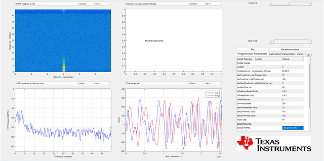

    First, I used mmWave Studio 03.00.00.14. Is it compatible with the AWR2243 evaluation module or not?
    Please see the attached photo showing if the data I evaluated using PostProc.

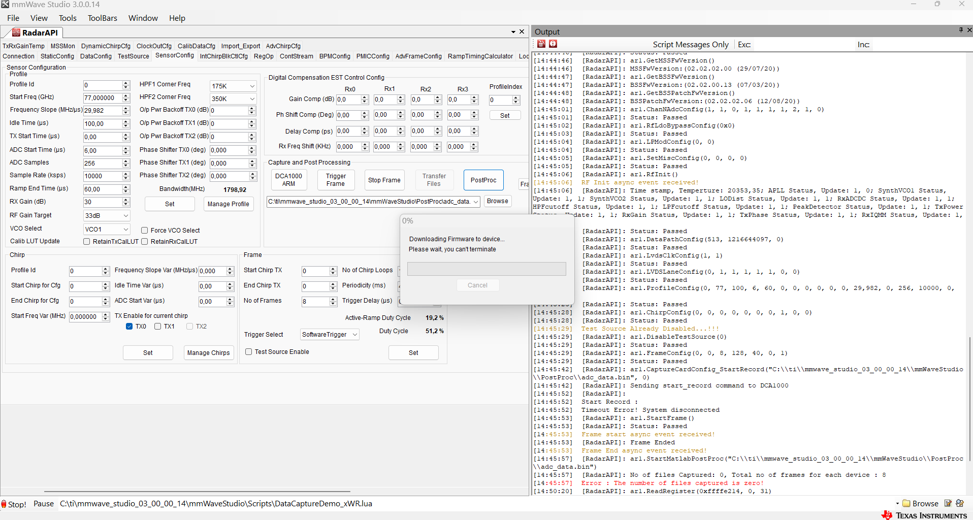

    Second, I ran the LUA script from the following RadarAPI path (see attached photo):
    C:\ti\mmwave_studio_03_00_00_14\mmWaveStudio\Scripts
    However, the script did not stop running—it seemed to keep trying to download the firmware to the device.

  • Please follow the instructions in this video:
    ttps://www.ti.com/video/5827389052001
    This video describes how to setup the capture manually using the GUI.
    You should follow these steps before we run the LUA script
    thank you
    Cesar
