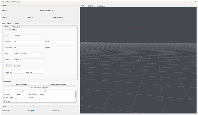

Hi TI,
Can't using visualizer to display on 3D-Plot (HECR FW under CAN)
Radar Board: AWR2944EVM Rev D.
Radar Toolbox: radar_toolbox_3.10.0.5
Demo: High end Corner Radar
Interface: CAN-FD
Can you setup by step describe about using Visualizer to display?
Thanks.

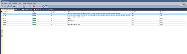

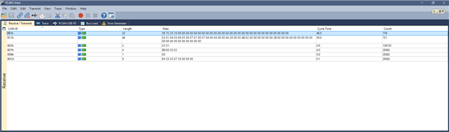

  • Hi Samhitha,
    you are using the makefile build system to rebuild the application.
    >>> YES, Did

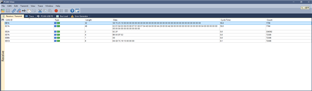

    Using PCAN-View to check , it's working well.
    Please help to list step by step,
    "How to using Visualizer under CAN-FD interface"
    Thanks.

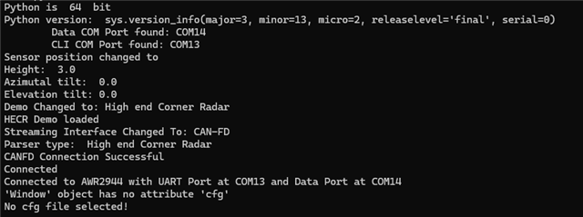

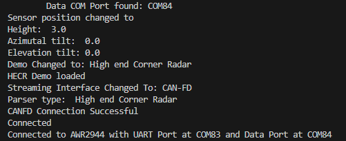

  • Hi HankChen,
    Choose the interface to be CAN-FD and click connect. Once the connection is established, you should see the below logs -
    Next click on Start without Send Configuration.
    Note: Open the visualizer and connect before running the application in CCS.
    Samhitha

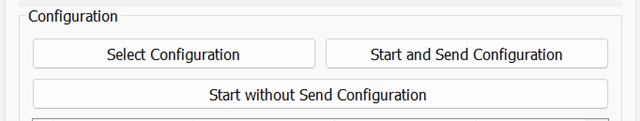

  • Hi Samhitha,
    will occurs error when second step: click on Start without Send configuration.
    Please help to check.
    Thanks.
    BR,
    HankChen
  • HankChen,
    Seems like you have clicked on "Start and Send Configuration" instead of "Start without Send Configuration". Click on "Start without Send Configuration".
    Samhitha

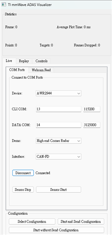

  • Hi Samhitha,
    nothing to shown..
    >>> Open Visualizer directly, not in CCS
    BR,
    HankChen
  • HankChen,
    I meant to establish the connection in visualizer before running HECR demo using CCS.
    Are you running the HECR demo in CCS or you have flashed the demo? If you are using CCS, can you halt the core and see if there is any assert?
    Samhitha
  • Hi Samhitha,
    Already flashed the demo FW to AWR2944EVM
    and
    Using PCAN-Viewer checked, it's working well.
    BR,
    HankChen
  • HankChen,
    In that case, after connecting to the visualizer and once the setup is ready, you can click on NRST button on EVM to reset the device. In HECR, since CLI is bypassed, Sensor starts immediately and tries to send the message over CAN. If CAN messages are not received through Visualizer or PCAN-View before next frame object data is available, the HECR application will hit an assert.

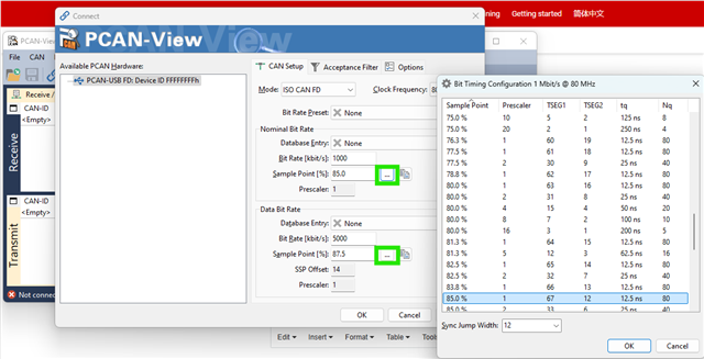

    If you followed the above-mentioned steps and still not able to see any plots, you can compare the CAN configuration in PCAN-View and the visualizer.

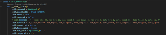

    The below screenshot shows the CAN configuration in visualizer - C:\ti\radar_toolbox_<ver>\tools\visualizers\Automotive_Visualiser\interfaces\canfd.py.

  • Hi Samhitha,
    canfd.py. setup same as your side
    (and it works on object detection mode, I think it's correct setup)

    In that case, compare the CAN configuration in PCAN-View and the visualizer. For this you can click on "..." button beside sampling point to check the bit timing configuration. The values that you have used in PCAN-View should match with the canfd.py configuration.
    Samhitha
  • Hi Samhitha,
    I've also tested it on my end, and it works now. It turned out to be a loose connection on the cable to the CAN adapter.
