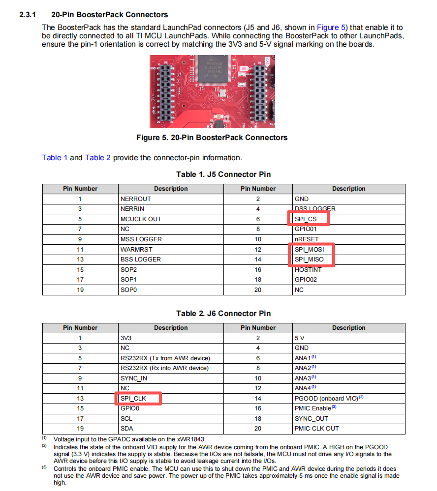

Now, I can output data normally from the UART port using the 1843 OOB firmware. The documentation states that the 1843 has two 20-pin BoosterPack Connectors on the back, which support both 232 and SPI. Now, I want to use this pin to output data from the OOB firmware. Is there any guidance document available, such as wiring instructions or software modification instructions.
    Unfortunately we don't have any example that shows how to use SPI for data transfer for 1843. We have some internal example that shows how to use SPI data transfer for 6843. This device is very similar to 1843 so you can use this example to start with.

    You should diff this example with the standard 6843 oob sdk demo to see the changes that were performed to send the data over SPI instead of UART.
