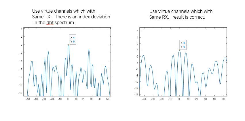

  • Hi Ali,
    This picture can be used as a reference.
  • Hi Shawn,
    There is high variability in the data, and the difference is only 1 dB.  Can you use some averaging to 'smooth' out the spectrum.  Also, are both plots using the same number of samples?  In the 2 plots looks like spectrum resolution is different between them.
    regards,
    Ali
  • In the figure, the x-axis represents the angle(°), and the y-axis represents the power spectrum (in dB). Our radar is a 6T8R system. Its virtual channels are denoted as TX1-RX1, TX1-RX2, ..., TX6-RX8.
    Test scenario: The radar is calibrated once in a dark room environment. After calibration, the radar is restarted. In the same environment, a test target with an angle of 0° is set.
    Previously, we enabled RX IQMM according to the default settings and restarted the system multiple times for testing. There was a probability of over 15% that the situation shown in the figure would occur:
    (1)The figure on the left is the power spectrum obtained after 2D-FFT, using the 5 virtual channels TX1-RX1, TX1-RX2, TX1-RX3, TX1-RX4, and TX1-RX5 to perform DBF. The peak of the spectrum is at the 1° position.
    (2)The graph on the right shows the power spectrum obtained by using the 4 virtual channels TX1-RX1, TX2-RX1, TX3-RX1, and TX4-RX1. The peak of the spectrum is at 0°.
    From the measurement angle results, there is an error in the phase difference between the receivers, which causes deviations in the measurement angle results.
    After we shut down the RX IQMM, we repeatedly restarted the system 200 times under the same conditions. Since then, this deviation has never occurred again.

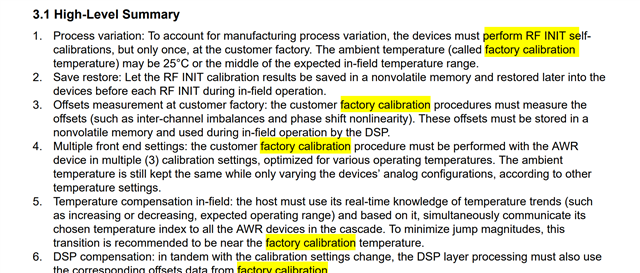

    I wanted to share the document:  Cascade Coherency and Phase Shifter Calibration
    This applications note points to a calibration strategy specially for cascaded systems. See summary below for summary.  Please review this document and I can clarify any questions you may have.
