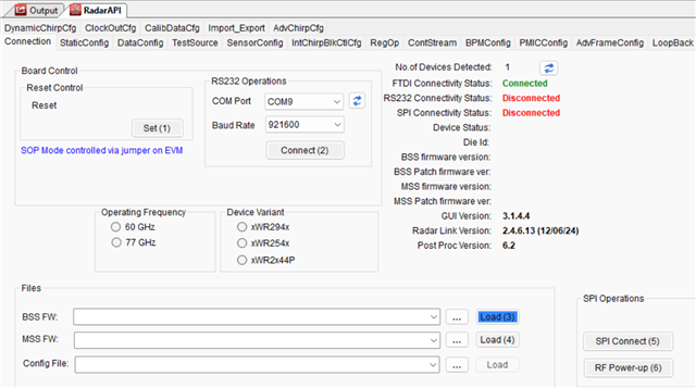

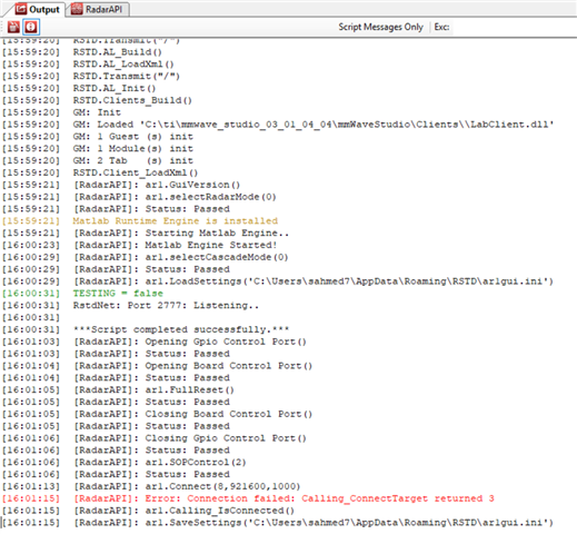

But, whenever I am connecting one micro-USB to the RADAR_FTDI port on DCA board, the FTDI ports do not appear in my device manager. However, when I am connecting the micro-USB to the FTDI port of the AWR board, the FTDI ports do appear in the device manager. Although it seems to be a temporary solution, I am getting "Connection failed: Calling_ConnectTarget returned 3" error in the mmWave studio output (picures attached). Also, the "RS232 Connectivity Status" remains disconnected in the RADAR_API (pictures attached). Can you please help me in solving the issue?

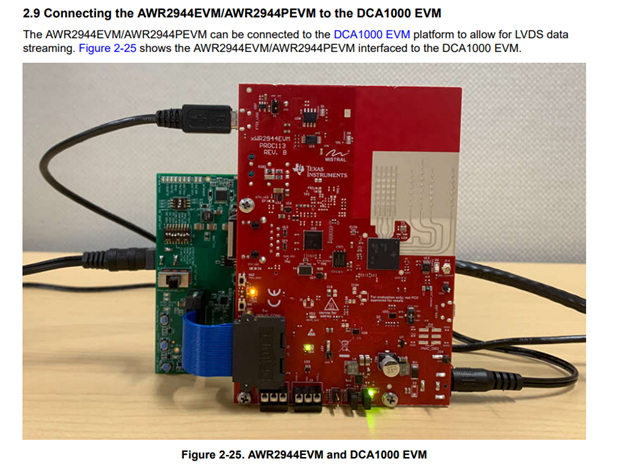

    With AWR2944EVM the USB should be connected to the FTDI port on the AWR2944EVM only. You should not be connecting USB to any ports on the DCA1000EVM with AWR2944EVM. This is described in section 2.9 of the AWR2944EVM user guide.

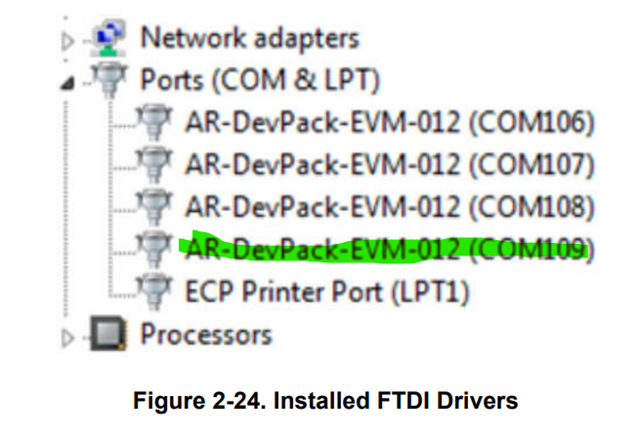

    Also, with AWR2944EVM the RS232 connection should be made with the highest number FTDI port. For example, if you see four ports instantiated like below, you need to select COM109 for the RS232 connection.

    This time, the XDS ports disappeared from the device manager. However, according to your suggestion, I did choose the highest number FTDI port for the RS232 connection
    However, the "RS232 Connectivity Status" still remains disconnected

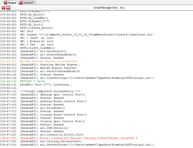

    with the same output error
    Can you please take a closer look to see if you can help me with some additional suggestion(s)?
