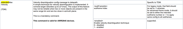

How can I view the point cloud results of awr2944_mmw_demoTDMEnet.appimage? In mmWave_Demo_Visualizer 4.7.0, the error "'extendedMaxVelo' is not recognized as a CLI command" appears.
TICSC
  • Hi TICSC,
    Please check the CLI commands in your .cfg file which you are sending over tera term. the correct command should be extendedMaxVelocity, looks like there's some typo in your cfg file.
    sharing a snippet below for your reference:
