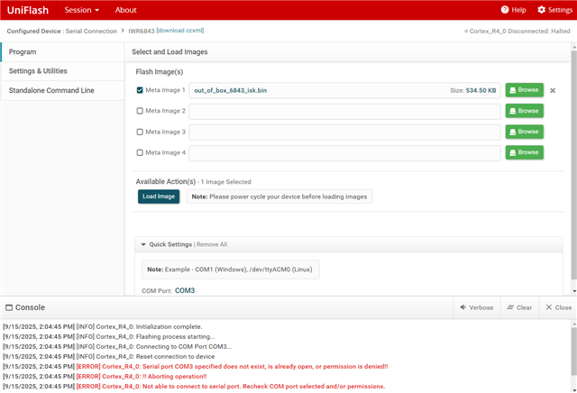

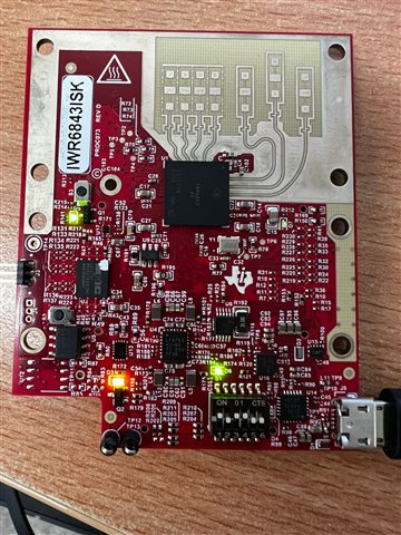

I just got the IWR6832ISK and want to run the out-of-the-box example on Windows 10. For this I need to flash the board using Uniflash.

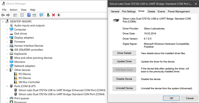

I installed Uniflash as well as the CP210x_VCP_Windows drivers and configured the DIP-Switches to flashing mode (1-0-1-1-0-0). Both COM-Ports appear in Windows Device Manager (Enhanced as COM3, Standard as COM4), however if I try to flash it, I get an output like this.
[9/15/2025, 2:04:45 PM] [INFO] Cortex_R4_0: Initialization complete.
[9/15/2025, 2:04:45 PM] [INFO] Cortex_R4_0: Flashing process starting...
[9/15/2025, 2:04:45 PM] [INFO] Cortex_R4_0: Connecting to COM Port COM3...
[9/15/2025, 2:04:45 PM] [INFO] Cortex_R4_0: Reset connection to device
[9/15/2025, 2:04:45 PM] [ERROR] Cortex_R4_0: Serial port COM3 specified does not exist, is already open, or permission is denied!!
[9/15/2025, 2:04:45 PM] [ERROR] Cortex_R4_0: !! Aborting operation!!
[9/15/2025, 2:04:45 PM] [ERROR] Cortex_R4_0: Not able to connect to serial port. Recheck COM port selected and/or permissions.
[9/15/2025, 2:04:45 PM] [INFO] Cortex_R4_0: Flashing instance clean-up initiated...
[9/15/2025, 2:04:45 PM] [INFO] Cortex_R4_0: Instance deinitialized!
The file I'm trying to flash is C:\ti\rdt\radar_toolbox_3_20_00_04\source\ti\examples\Out_Of_Box_Demo\prebuilt_binaries\out_of_box_6843_isk.bin

  • Uninstalled and reinstalled the CP210x drivers. Also tried the Windows Universal and the VCP_Windows variant.

  • Physically moved all DIP-switches to ensure they register in the proper orientation
  • Toggling the NRST-switch multiple times, also directly before a flashing attempt
  • Tried all permutations of plugging in the USB and then starting up Uniflash or vice versa
  • Switched to a different Machine, went through all steps clean again, same problem.
  • Verified I have the correct revision of IWR6832ISK board (678A on the board)
