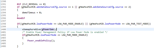

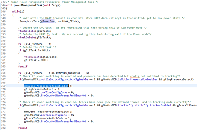

  • Hi Zigang,
    I haven't tried the demo code yet, but I've found that the code only performs the profile switching in the powerManagementTask(Figure 1 below) and the semaphore “gPowerSem” is unlocked only when LPDS is in LOW_PWR_MODE_ENABLE or LOW_PWR_TEST_MODE(Figure 2).
    I'm not sure if I misunderstood the code.
    Figure 1
    Figure 2
    KT Lin
