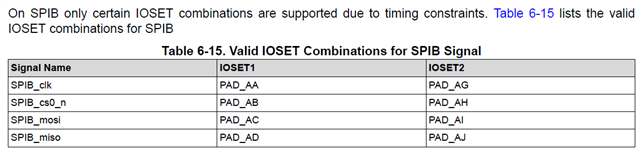

In AWRL6844 datasheet, you can see the SPIB signal IOSET table below.
However, what is PAD_AA, PAD_AB..., there's no such pad in AWRL6844.
Could you clarify?

I realize PAD_AA mapping to pin number B14, PAD_AB mapping to pin number A13. Such mapping can be found in table 6-19.
This ticket can be closed if my understanding is correct.
