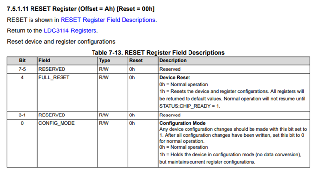

  • We have bought LDDC3114. I am trying to use it in the raw mode, but I can't get interrupts on INTB output running. I have sensors connected to channels 0 and 1, channels 2 and 3 are not connected and disabled in the ENABLE register. No matter what I set in the INTPOL register, interrupts are not triggering
  • Jakub,
    In raw mode, the interrupt should be asserted when new data is available.  Be sure you are putting the device in to config mode before making any changes to registers.  After the new register changes are complete, you can set this back to normal operation.
