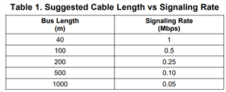

    Thanks for posting your question regarding MCAN. My guess is here that you're either not getting an acknowledgement of the CAN message or a bit error is occurring during message transmission. Listed below are a few notes on design needs or possible error causes, though I would also recommend reviewing the following application note on CAN physical requirements:
    • There must be at least two CAN nodes for acknowledgement
    • Both ends of the CAN line should be terminated with a 120 ohm resistor between the CAN low and CAN high lines to prevent reflections from impedance mismatching
    • There must be isolated common ground for the bus to prevent noise injection
    • Ensure the bus length does not exceed the supported baud rate
      • The High-Speed ISO 11898 Standard specifications are given for a maximum signaling rate of 1 Mbps with a bus length of 40 m with a maximum of 30 nodes. It also recommends a maximum unterminated stub length of 0.3 m
