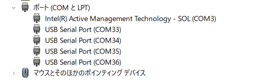

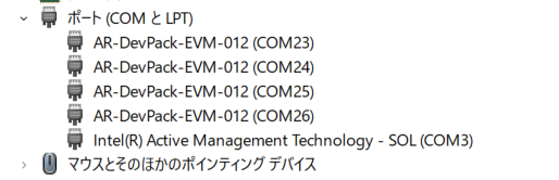

Hello
My customer uses multiple IWRL6432AOP EVMs , they are using FTDI I/F.
Then , some of the board r(little bit older board) is recognized as follows and worked well.
But many of others (recently purchased one) are recognized as follows and not worked.
Can you please advice how to resolve this issue?
A.Fujinaka
    Can you please share a picture of the working and non-working boards? For the non-working boards, is the customer testing with the same software flashed and same laptop/cables as the working board? The ports being recognized as AR-DevPack-EVM-012 is expected when the correct FTDI drivers are installed.
