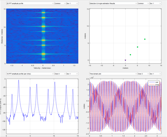

MMWCAS-RF-EVM: Same ADC Output regardless of the direction of pointing the board
Part Number: MMWCAS-RF-EVM
I am using the MMWCAS-RF-EVM board, with its attached DSP board. I have set the board up, and have run the Cascade_Configuration_MIMO.lua script followed by the cascade capture lua script. When I do the default post-processing in mmWave Studio, I have observed that the output is the same regardless of where I point the radar. I tried using a corner reflector, and it wasn't getting detected. Even covering the antenna with my hand at a close distance led to the same output. One thing to note is that if I run the Test Source lua configuration script, I get a different output than the mimo configuration, but this is also constant regardless of where I point the radar. Any help would be appreciated here.
