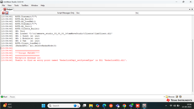

I am trying to use mmwcas-rf-evm and mmwcas-dsp-evm with mmWave Studio, but I keep getting the following error:
Exception message is:
Unable to find an entry point named 'RadarLinkImpl_setSystemType' in DLL 'RadarLinkDLL.dll'.
Here is what I have already tried:
  • Tested with mmWave Studio 2.1.1.0 (latest release) and also 3.0.0.14.

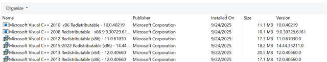

  • Verified that Microsoft Visual C++ 2013 Redistributables (x64 and x86, version 12.0.40660) are installed (see attached screenshot).

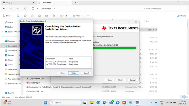

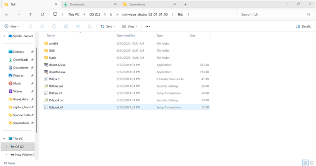

  • FTDI drivers were installed correctly during mmWave Studio setup at: C:\ti\mmwave_studio_02_01_01_00\ftdi (see attached screenshot)

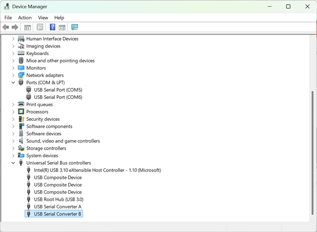

  • Attaching screenshots of my device manager

(Attached screenshots of the error, redistributables installed, and FTDI driver info.)

    Also, I had installed mmWave Studio in admin mode while the hardware was connected. The installation wizard showed the FTDI drivers being successfully installed (refer to the above screenshots), and I can also see them under the FTDI folder (screenshot attached). Could you please check my Device Manager screenshot and let me know if this looks like a driver issue?

  • My DLL issue is resolved and I just wanted to post here for public information -
    It turned out that the issue was not related to the DLL or FTDI driver. The problem was with the Microsoft Visual C++ Redistributable Packages version mentioned in the manual.
    The manual listed the 2013 package, but that alone did not solve the issue. I had to install multiple versions of the redistributable packages. Specifically, I downloaded and installed the following x86 versions:
    • Microsoft Visual C++ 2012 Redistributable
    • Microsoft Visual C++ 2013 Redistributable
    • Microsoft Visual C++ 2015–2022 Redistributable
    After installing these, the software finally worked. I cannot pinpoint whether a single package fixed the issue or if it required the combination of 2012, 2013, and 2015–2022.
