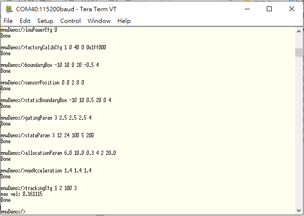

    Customer report configurations of tracking are weird in the newly upgrade SDK 5.5.4.2. They use IWRL6432 EVM burned with SDK v5.5.4.2 Motion and Presence Detection with attached configuration. Turn on the radar and see the input of the maximum and resolution of velocity in the tracking configuration by using the CLI_write function to output the observed the result.

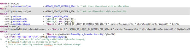

in SDK 5.5.4.2, the maximum velocity is calculated itself rather than inputting by the tracking configurations.
“config.maxVelocitymps                 = (float) ((10 * (SPEED_OF_LIGHT_IN_METERS_PER_SEC/(4 * carrierFrequencyMhz * chirpRepetitionPeriodus))) * 0.1f);”
 as you can see
The radar outputs the value of config.maxVelocitymps, and it is 0.16115 m/s which is not the correct value of maximum velocity. The configuration is having max velocity of around 11 m/s.

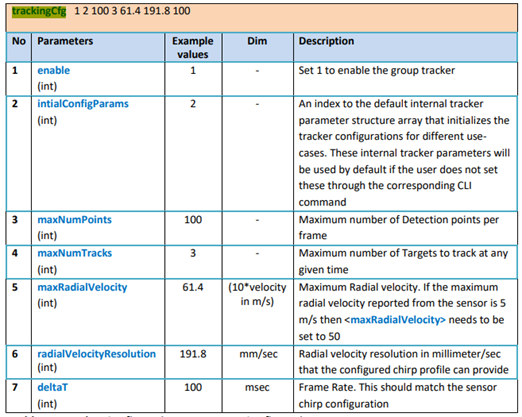

Note that, in previous version (v5.5.3.0), the radar does not calculate the maximum and resolution of velocity in the tracking configuration itself, instead, the velocity info is inputted by using the tracking configuration. Below is the reference of the tracking configuration example in the previous SDK v5.5.3.0.

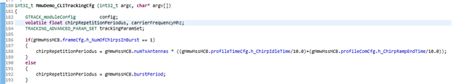

    In the last SDK update we removed some parameters from trackingCfg as they were redundant, they are required to be calculated based on other chirp parameters and could easily lead to being mismatched and incorrectly configuring the tracker module. So these parameters are now calculated internally before being given to the tracker. The calculation was not meant to be changed, this is the result of a bug that we are already aware of. We may be releasing small update to address this bug but I can't say for certain when that would be available. In the meantime please refer to the fix below:
    Line 186 of tracker_utils.c shown in the picture below needs to be changed and the example rebuilt.
    Change line 186 from:
    if(gMmwMssMCB.frameCfg.h_NumOfChirpsInBurst == 1)
    to:
    if(gMmwMssMCB.frameCfg.h_NumOfBurstsInFrame == 1)
    Josh
