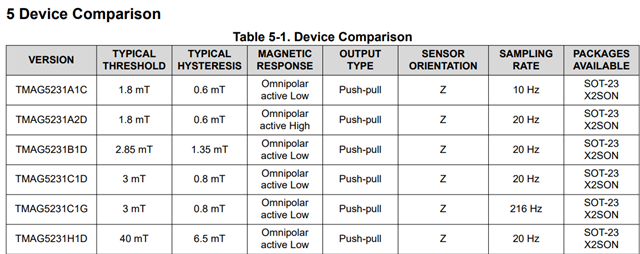

Does the sampling rate depends on the voltage of the TMAG5231C1G?
If so, is there any graphic where I can see how it changes depending on it?
No, the sampling rate does not depend on the supply voltage. The sampling rate is fixed during manufacturing and will depend on which variant you chose, see the list of sampling rate options below:

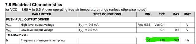

Hello Alicia,
Thanks for your answer. I mean for a specific version, in this case the TMAG5231C1.
It has a minimum (136 Hz), typical (216 Hz) and maximum(374 Hz) sampling rate . Does this depends on the voltage?
Hi Antonio,
Thank you for clarifying. What impacts the sampling rate the most is going to be the temperature. As when the temperature increases, you can generally see the frequency decrease.
