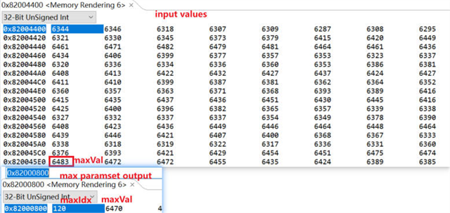

when i use max paramset to calculate maxIdx and maxVal, i find maxIdx is correct, however maxVal is error.
The phenomenon is shown in the figure below, have you encountered similar problems before?

Hi Peng,
What is configuration of the input and output formatter? I suspect that you are scaling the input and output using srcScale and destScale parameters.
