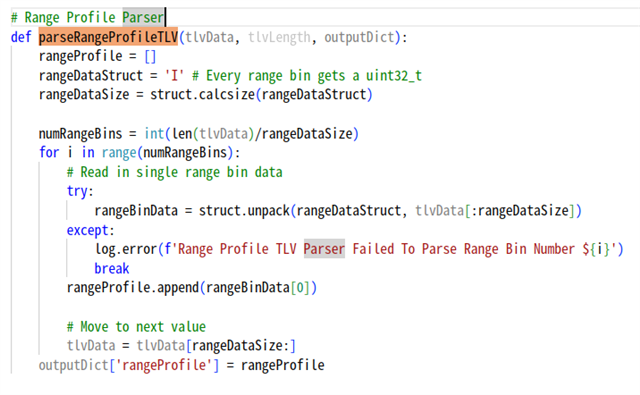

    I looked for the Python code you mentioned, but I couldn’t find it. Where is it located? I searched in <MMWAVE_SDK_03_06_02_00-LTS-LINUX-X86-INSTALL> that I installed. I don’t think it’s in mmwave_sdk_03_06_02_00-LTS/packages/ti/demo/parser_scripts. But since the issue still occurs in the web-based visualization demo app, I guess the results will be similar even if I run it using the Python code.
    We recently ordered a new board, which was supposed to come pre-configured. I tested it, and the results were similar. If it’s not a frame configuration issue, could it really be a cable problem? Hmm.
    Please look at the python source code present in the radar toolbox. You need to first install radar toolbox online and then you can navigate to this folder
    {TOOLBOX_DIR{\tools\visualizers\Applications_Visualizer to view the source code.

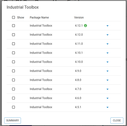

    Then, I installed industrial toolbox.
    It seems like this caused a file to appear in the path '/home/ti/mmwave_industrial_toolbox_4_12_1'
    Is this the source code that you mentioned?

    1.

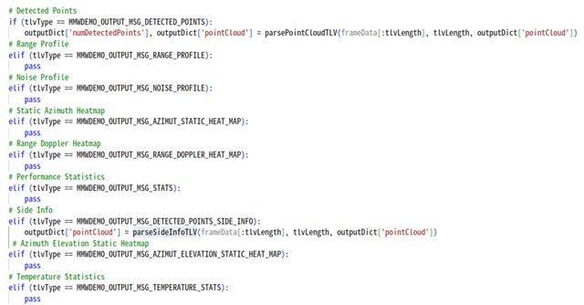

    I found the functions corresponding to each TLV, but when I searched for their names, I could not find any places where they are called. Could you tell me the correct part where they are called?
    2.

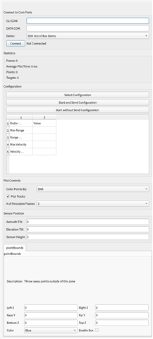

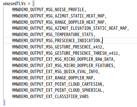

    I found this code,
    Are 3, 4, 5, 8, 9 unused? In the demo app below, it was selectable.
    https://dev.ti.com/gallery/view/mmwave/mmWave_Demo_Visualizer/ver/3.6.0/
    How should I understand this?
    3.

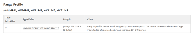

    I think the Python code does not match the protocol. According to the TI Radar Toolbox documentation, TLV type 2 should be read as 2 bytes per value, but the Python code reads 4 bytes. Also, how should the Q-format scaling be applied?
    python code in /home/user/ti/radar_toolbox_3_20_00_04/tools/visualizers/Applications_Visualizer/common/parseTLVs.py
    protocol in:
    https://dev.ti.com/tirex/explore/content/radar_toolbox_3_20_00_04/software_docs/Understanding_UART_Data_Output_Format.html#detected-points

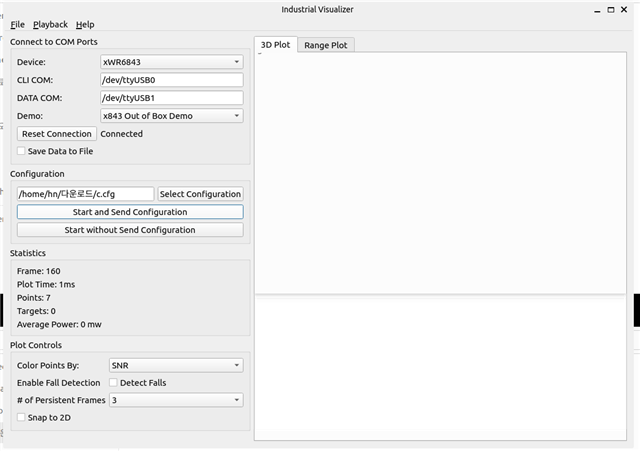

    Can you try executing the demo with this industrial visualizer present in the radar toolbox first? For the size of the data, I would suggest you to correlate with whatever is present in the demo C code.

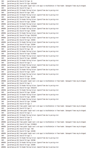

  • I tried it, but the result is the same. When the profile is enabled, the TLV type data comes in corrupted. If I disable the profile and only select scatter and stats, the number of corrupted TLVs decreases significantly.
    Below is the log when the profile is enabled.
    However, when I use the app, the display doesn’t render properly — though that seems unrelated; it looks more like a graphical issue.
