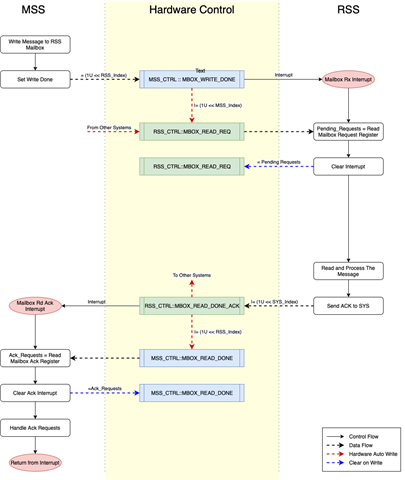

Looking at Figure 26-2, if HSM and R5F follow the same register handling and process flow, can they achieve the same effect?
Figure 26-2. Mailbox Message Scheme between Cores
