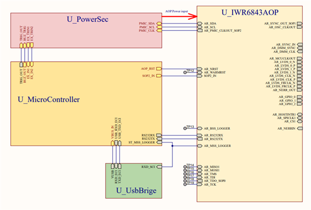

Dear TI Team,
We have built a custom board out of IWR6843AOP. But we are facing issues with uploading the user-application/firmware into the IWR6843AOP.
ERROR:
[9/30/2025, 1:13:39 PM] [ERROR] Cortex_R4_0: XXXX Received unexpected data!!!XXXX
[9/30/2025, 1:13:39 PM] [ERROR] Cortex_R4_0: Not able to connect to serial port. Recheck COM port selected and/or permissions.
Important/Relevant Circuit
1. Block Diagram

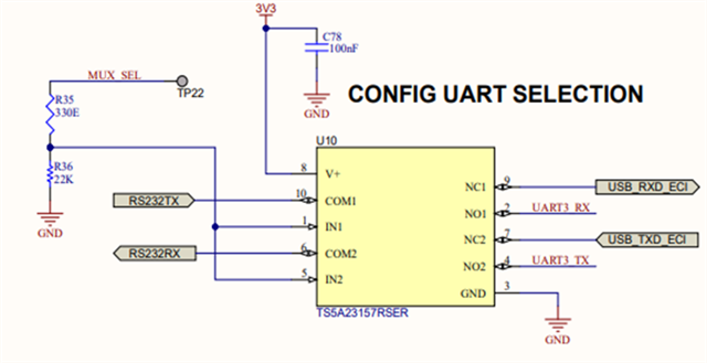

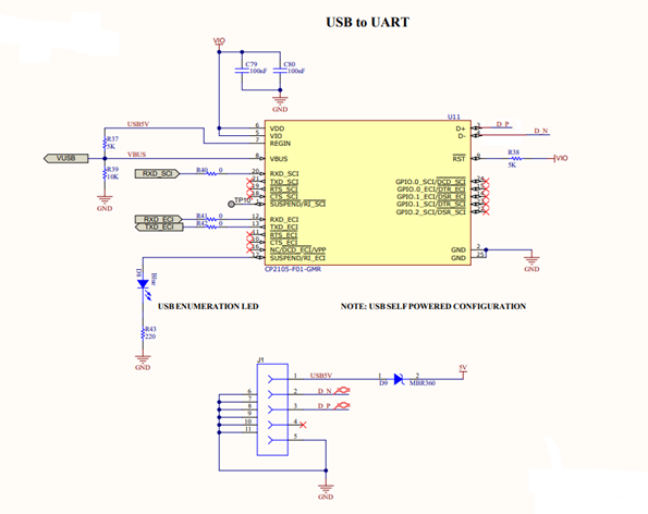

2. USB-TO-UART
3. UART SELECTION MUX
MUX_SEL: CONTROLLED FROM STM32
MUX_SEL
OUTPUT
0
RS232TX, RS232TX of IWR routes to CP2105 and then finally to USB
1
RS232TX, RS232RX of IWR routes to STM32UART

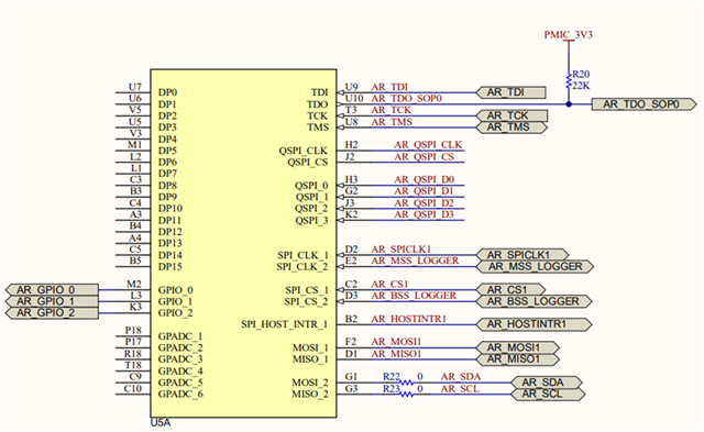

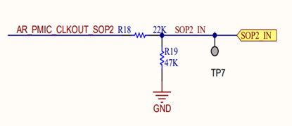

4. SOP [2]
SOP2_IN -> SIGNAL FROM STM32
5. SOP [1]: Always tied to 0
6. SOP [0]: Always tied to VCC

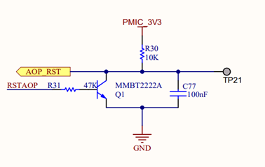

7. IWR6843AOP RESET CIRCUIT

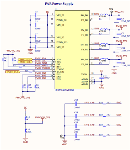

 8. PMIC

1
2 COM PORTS ARE BEING SHOWN IN DEVICE MANAGER
(Standard & Enhanced)
2
VIN_B0, B1, B2, B3 of PMIC is 4.77V
3
PMICVIO_3V3 is 3.08V
4
PMIC_3V3 = 3.3V
5
PMIC_1V2 = 1.2V
6
PMIC_1V0 = 1V
7
PMIC_1V8 = 1.8V
8
VOUT_PA_SUPPLY / AR_1P0_RF2 = 1V
9
AR_1V4_SYNTH = 0V
10
AR_1V4_APLL = 1.36V
11
SOP [2:1:0] = 101 (For flashing mode)
SOP2: 3.1V
(In original schematic R18 was 22K, Changed it on the board to 1K)
SOP1: 0V
SOP0: 3.32V
12
AR_VBGAP = 0.88V
13
AR_WARMRST (It is always low …. I am not able to see
logic 1-> 0 at nRESET 0->1 on my oscilloscope
Moreover, in the reference design of the EVK. It is pulled up to 3.3V.
14
AR_NRST = AOP_RST = 3.21V
15
MUX_SEL = 0V

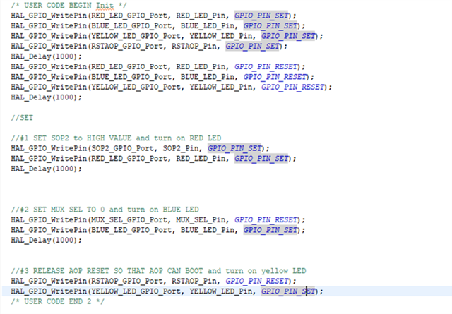

To ensure there is no race condition and SOP2 value (controlled by STM) stabilizes before AOP is booted. We again pull AOP_RST to low for some time after SOP is stabilised using the below code
Any help regarding the above situation will be highly appreciated.
