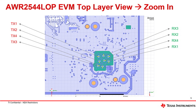

I found a slide on E2E forum that is showing the structure of the ports of the antenna. It seems these different ports have different polarizations.
Can you give me some explaination? Since I am doing some scaning use this board and I want to know if these ports or antennas have any polarizations.

    The arrows shown on each TX/RX port in the model are only the feed port orientation markers. It shows how energy enters or leaves that feed point on the device not the radiated polarization. All TX/RX elements radiate the same linear polarization.
