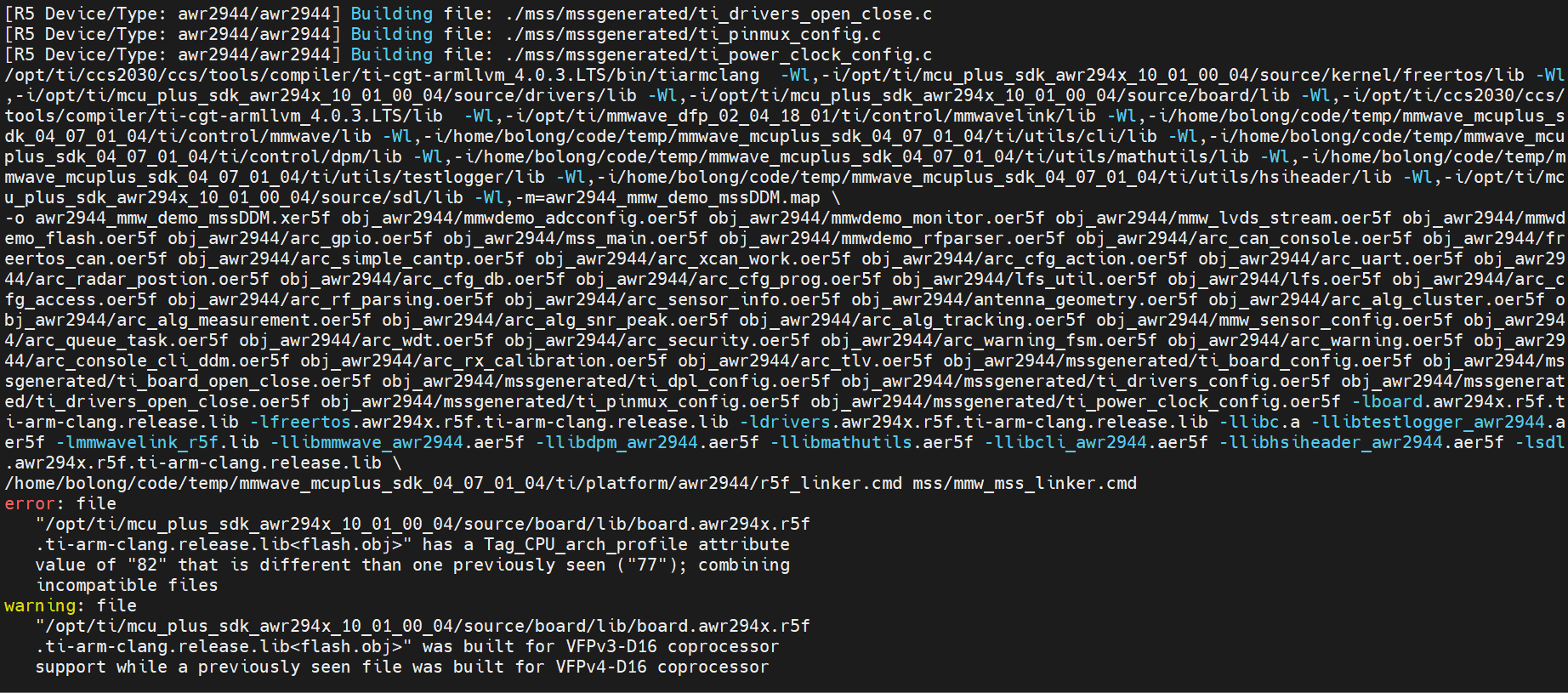

AWR2944: unknown compiler error
Part Number: AWR2944

my sdk is mmwave_mcuplus_sdk_04_07_01_04
other environment are as following:
mcu_plus_sdk_awr294x_10_01_00_04
ccs2030
sysconfig_1.23.0
ti-cgt-armllvm_4.0.3.LTS
ti-cgt-c6000_8.5.0.LTS
mmwave_dfp_02_04_18_01
dsplib_c66x_3_4_0_0
mathlib_c66x_3_1_2_1
xdctools_3_62_01_16_core
Please help to check the error messages mean?

    I just try to build sdk mmwave_mcuplus_sdk_04_07_01_04 on ddm type.
    My syscfg is as following code to replace mss.syscfg.
    Environment is linux.
    I make clean before every time build.
    It seems related about following CPU setting.
    Because the compiler result in the same environment is different. C66 seems better than R5F.

    Why are you setting the MSS_CPU to the C66?
    The MSS code is meant to run on the R5F core. If you change that code back does it build?
    Gabriel
    I original code use R5F to MSS_CPU and found the bug.
    Because the error message say related CPU, I try to test and change to C66 to see the result is different yesterday.
    I found a old question is the same like me as following  AM2634: errors encountered during linking to a static library
    Can you help to tell me how to fix it step by step?

    Gabriel
  • Hi Gabriel:
    Please build on linux environment.
    Because my environment is linux not windows.
    Bolong

    I do not have access to a linux system at the moment. Are you not able to use windows?
    If not please give me a few days to get a linux computer and test on my end
    Gabriel
    We only use linux server to compiler.
    You can take few days to test it.
    May I need to use TI CCS tool and input arc.syscfg to get ti_xxx.c then copy them to replace tiles in mss/mssgenerated or dss/dssgenerated folder?
    Thnaks,
    Bolong
