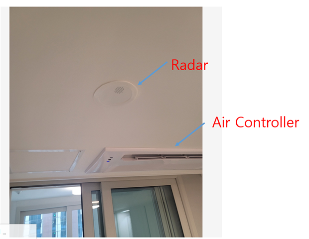

The current default settings are as follows:
sensorStop 0
channelCfg 7 3 0
chirpComnCfg 8 0 0 256 4 23 0
chirpTimingCfg 6 18 0 75 60
frameCfg 2 8 580 32 133 0
antGeometryCfg 0 0 1 1 0 2 0 1 1 2 0 3 2.418 2.418
guiMonitor 2 0 0 0 0 1 0 0 1 1 1
sigProcChainCfg 32 2 1 2 4 4 0 15
cfarCfg 2 8 4 3 0 12.0 0 0.5 0 1 1 1
aoaFovCfg -70 70 -40 40
rangeSelCfg 0.1 10.0
clutterRemoval 1
compRangeBiasAndRxChanPhase 0.0 1.00000 0.00000 -1.00000 0.00000 1.00000 0.00000 -1.00000 0.00000 1.00000 0.00000 -1.00000 0.00000
adcDataSource 0 adc_data_0001_CtestAdc6Ant.bin
adcLogging 0
lowPowerCfg 0
factoryCalibCfg 1 0 40 0 0x1ff000
boundaryBox -2 2 0 5 -0.5 3
sensorPosition 0 0 1.1 0 0
staticBoundaryBox -1 1 0.5 3 0 3
gatingParam 3 2 2 2 4
stateParam 3 3 12 500 5 500
allocationParam 6 10 0.1 4 0.5 20
maxAcceleration 0.4 0.4 0.1
trackingCfg 1 2 100 1 61.4 191.8 100
presenceBoundaryBox -1 1 0.5 3 0 3
microDopplerCfg 1 0 0.5 0 1 1 12.5 87.5 1
classifierCfg 1 3 4
baudRate 1250000
sensorStart 0 0 0 0
These data were measured when no one was present.

I would like to know how to improve the above issues.
Thank you.
