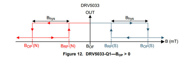

  • Hi Scott,
    Thank you for your quick support and response. Can we consider DRV5033-Q1 for this. Could you cross check if it will work on for our application. Also tell us if this will be better than 3D Hall effect sensors.
    Vishaal S
  • Vishaal,
    DRV5033-Q1 is an open drain output device, so the idle state is pulled-high
    So at B=0 you will be at Vcc, but when a field is applied above BOP you will have the output driven low.  You could use this, but if you need to have a low output at B=0 you would need to place an inverter in series with the output signal.
    Scott
