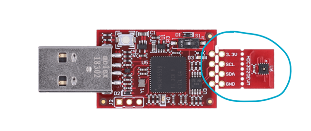

    Unfortunately, we don't have an IBIS model available for the HDC3022 at this time. The best I can suggest is either ordering an HDC3020EVM with the MCU which would allow you to evaluate the sensor with the GUI and break off the sensor later if desired.

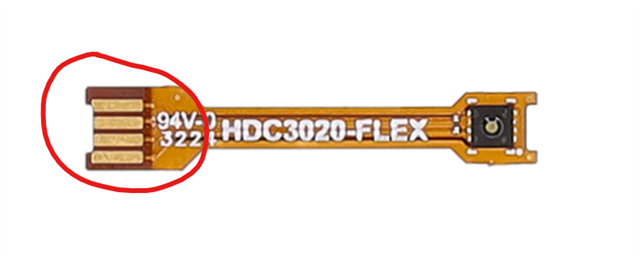

    Or, if you just need the sensor, the HDC3020FLXEVM can be integrated into your test setup via soldering wires to the gold fingers. From there, you can evaluate the I2C performance in real-time.

    To get the most accurate and real-time analysis of the HDC3020's I2C performance. I would highly recommend ordering the HDC3020FLXEVM as mentioned above since it's a straightforward plug and play sensor, and can be directly integrated into your test setup. There are unfortunately no alternatives in terms of modeling at this time for the HDC3020.
