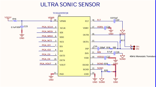

Hi all,

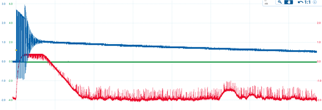

I'm working with a TUSS4470 and a 40kHz monostatic transducer, and I'm unable to get any stable(or not) echo. I don't have access to the development kit for this particular IC TUSS4470.
I have provided my circuit schematics and the oscilloscope outputs for VOUT and Transducer (+) pins below and also the register configs that I'm messing with to no avail...
Please check my circuit if anything is placed incorrectly or not.
KRP
(Yellow: Transducer (+), Blue: VOUT)
