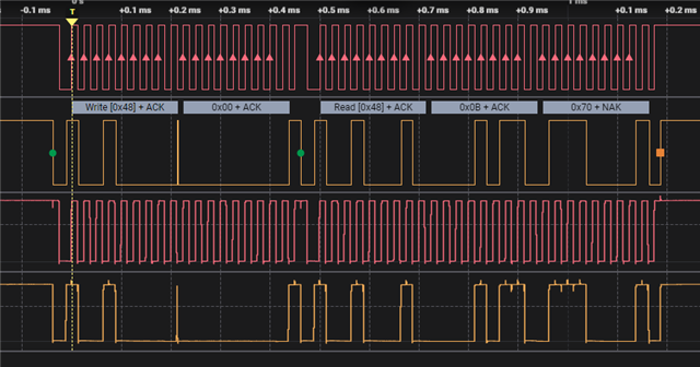

  • TMP468 should respond to i2cdetect. Are you sure 0 is the right bus for your hardware?
    Please share schematic.
    Please share logic analyzer/oscilloscope capture of the bus activity.
    Here is TMP468 responding to my i2cdetect and i2cget:
    ren@raspberrypi:~ $ i2cdetect -y 0
         0  1  2  3  4  5  6  7  8  9  a  b  c  d  e  f
    00:                         -- -- -- -- -- -- -- --
    10: -- -- -- -- -- -- -- -- -- -- -- -- -- -- -- --
    20: -- -- -- -- -- -- -- -- -- -- -- -- -- -- -- --
    30: -- -- -- -- -- -- -- -- -- -- -- -- -- -- -- --
    40: -- -- -- -- -- -- -- -- 48 -- -- -- -- -- -- --
    50: -- -- -- -- -- -- -- -- -- -- -- -- -- -- -- --
    60: -- -- -- -- -- -- -- -- -- -- -- -- -- -- -- --
    70: -- -- -- -- -- -- -- --
    ren@raspberrypi:~ $ i2cget -y 0 0x48 0 w
    0x700b
    Here the SMBus Word is byte-swapped, such that 0x700b reported was transmitted 0x0B first, and should be interpreted as 0x0B70 = 22.875C

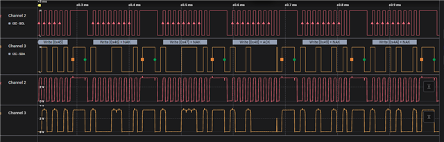

    • oscilloscope capture of the bus activity during
      ubuntu@ubuntu:~$ sudo i2cget -y 0 0x48 0 w
      Error: Read failed
    • Schematics
  • There's no activity on your oscilloscope. The time scale is not appropriate for typical I2C activity; you will need a finer time scale.
    I also recommend using 0ohm to tie ADD pin to GND. The sensor may not reliably detect the pin state if the resistance is too high.
    ren
