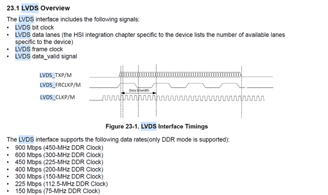

    One more question concerning LVDS data speed transfer. The documentation provides this equation:
    "Tc * n * B / 8 >= round-up(numAdcSamples * numRxChannels * 4 + 52, 256)"
     With " n-lane LVDS with each lane at a maximum of B Mbps", what is the data transfer rate B by default in HECR demo?
    In the TRM it lists the possible data rates:
    On the other hand the chirp_design_HECR.h file under the section CSI2 configuration specifies HECR_DATA_RATE as 1U, which is commented as 600Mbps, is this the LVDS data rate, i.e. B?
