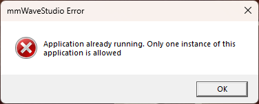

I cannot start mmWave Studio. I have tried uninstalling and reinstalling it, and this error never clears. Can you help me clear this so I can proceed?

Thanks for reaching out regarding this error in mmWave Studio. Do you have MATLAB Runtime 8.5.1 installed? This is needed for the application to run and is mentioned in the tools and dependencies of the release notes.

This did not help. Is there some data in the registry or in an AppData folder that needs to be cleared?

Just to confirm, have you checked to see if there is an existing task in Task Manager? Have you attempted to run mmWaveStudio after restarting your PC? This doesn't appear to be a start up issue, but you could try deleting the RTSD under C:\Users\<name>\AppData\Roaming and relaunching the app.
