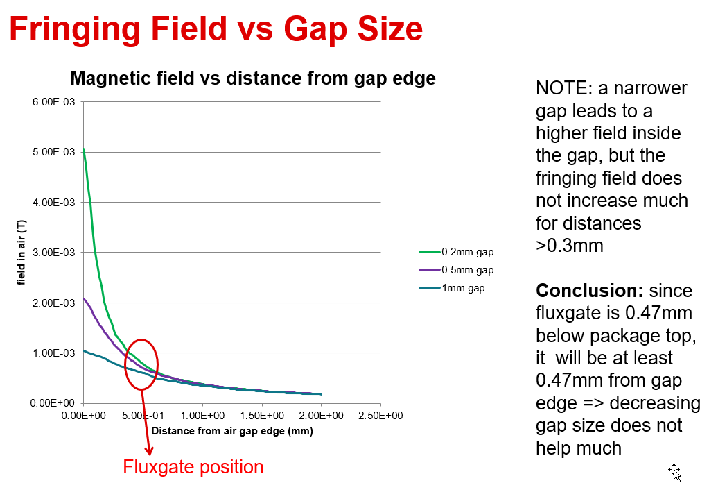

    -"3) The smaller the air gap the better the magnetic gain and external noise rejection. But there are diminishing returns after about between 0.1mm to 0.3mm because the sensor inside the DRV421 is 0.4mm inside the package and the sensor cannot get any closer to the air gap." ~ Patrick Simmons
    What does the quote mean?
    I understand it as, the gap of the core (not talking about the slot for the sensor) cannot be bigger than 0.3mm as is puts the sensor in diminishing returns.
    With kind regards,
    Emanuel
  • Hello Emanuel,
    Here is a plot that shows the gain with smaller air gap is large as you get closer to the air gap.  You see that even though you have larger gain with smaller air gap at the sensing location you will have less gain as you mover further away from the air gap.  The limit is the sensor location in the package as you cannot get the sensor closer than 0.47mm.  All this can be simulated using FEMM.  The Script I have written and can be downloaded can be used to verify all these are the files I would use.  The PPTX shows how to use FEMM with the script.

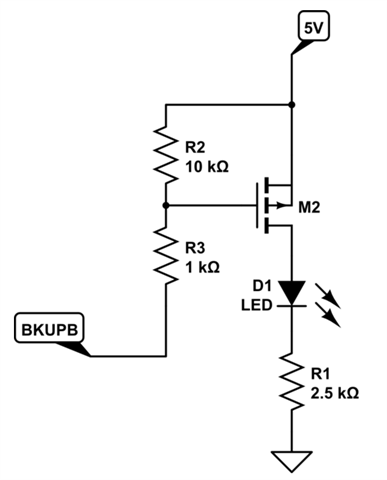

    The chip has the pins OR and ER as open drain active low. I'm trying to indicate the status of these pins with an LED. I am reading a lot about possibly damaging the pin due to high current. I have also seen this circuit coming around.
    My question is, what maximum current does the ER and OR pin allow? As these values are not shown in the datasheet, is a NPN transistor used for the ER and OR pins?
    Kind regards,
    Emanuel
  • Hello Emanuel,
    Normally these are specified with an output votlage at a specific current level.  So after some amount of current the resistance of the internal FET that is diving in low will not be able to provide the current.  I would not go over 25mA but recall the votlage drop will increase and may not give you the output low voltage desired once there is more current.  Depending on the LED current requirements you could drive it from 5V to resistor to LED.
