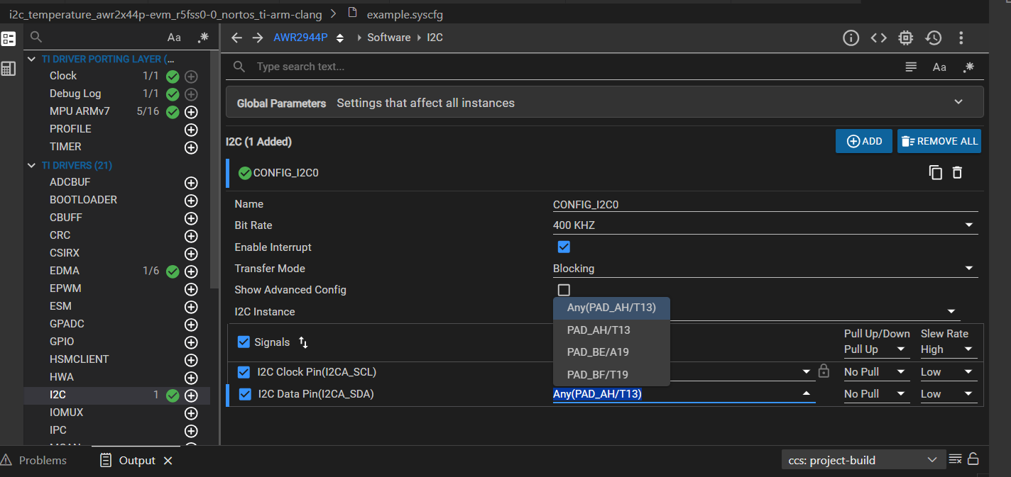

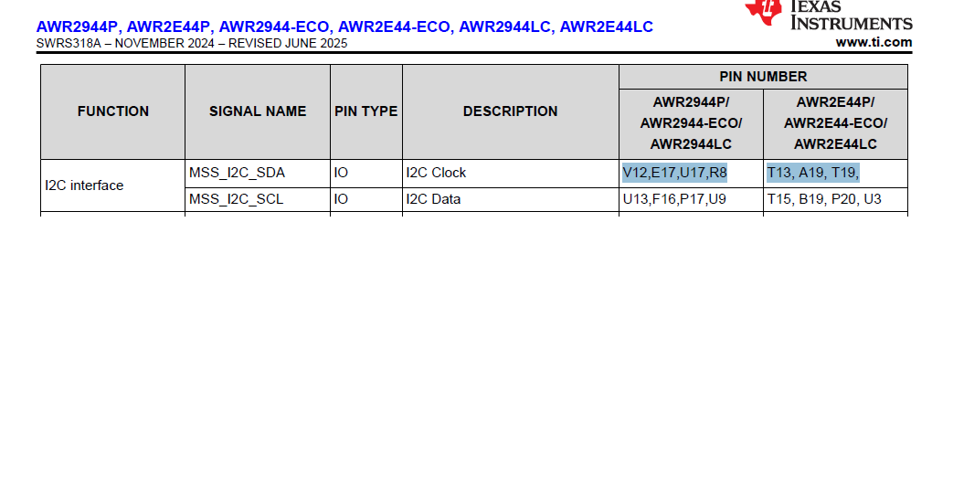

SYSCFG 1.23
Port the driver example in AWR2X44P, check the syscfg, find the pin definition is for AWR2E44P, take I2C as example, shown in below figure, for I2C SDA can select pin T13/T19A19 which are for AWR2E44P. From below datasheet figure we can see for AWR2944P there are four pins for I2C SDA, and in AWR2944P EVM, R8 is selected, then how to configure the syscfg? 2222.png
