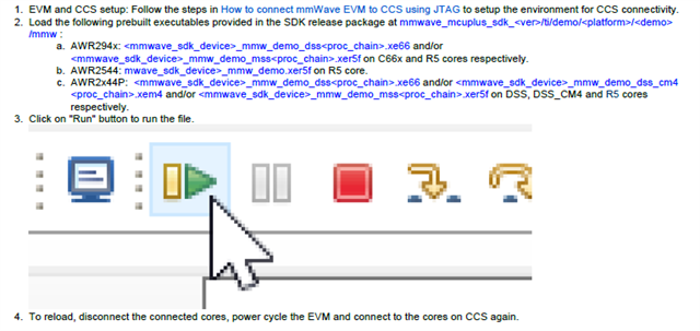

Hi team,
I put R5F0 and DSP in the same group, imported their respective images and clicked run, but R5F and DSP cannot run programs simultaneously. How do I set them to run at the same time?
SDK version: mmwave_mcuplus_sdk_04_06_01_02

  • Hi Roy,
     CCS cannot run multiple cores such as R5F and DSP simultaneously as a group. They have to be loaded and run separately.
    Ananya K C

  • Hi Roy,
    This feature is not supported in 2944 — even though it works on AWR1843, it is not supported on AWR2944. CCS cannot run multiple cores such as R5F and DSP simultaneously as a group; they have to be run separately.
    Could you please share what specific blocker the customer is facing by not being able to group the cores and run them together?
    Ananya K C

  • Hi Roy,
     Sorry for the delayed response. It is not possible to run both cores simultaneously in CCS.
    The program execution proceeds only after all cores have been initialized — until then, it remains in a wait loop. This behavior effectively mimics simultaneous execution of the cores.
