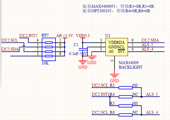

Under normal circumstances, the key backlight turns on when the sensor is blocked; when light of a certain intensity irradiates the sensor, the key backlight turns off. The block diagram of the working principle is shown in Figure 1.
Figure 1
SCH
As can be seen from the schematic diagram, the device we use adopts a compatible design for two types of components. In actual production, the OPT3001 is utilized, which is connected to the corresponding pins of the CPU via an I2C bus and equipped with a 10K pull-up resistor. The CPU of the display terminal periodically configures and detects the registers of the OPT3001 to collect the ambient light value. When the ambient light is lower than the threshold, the CPU turns on the key backlight.

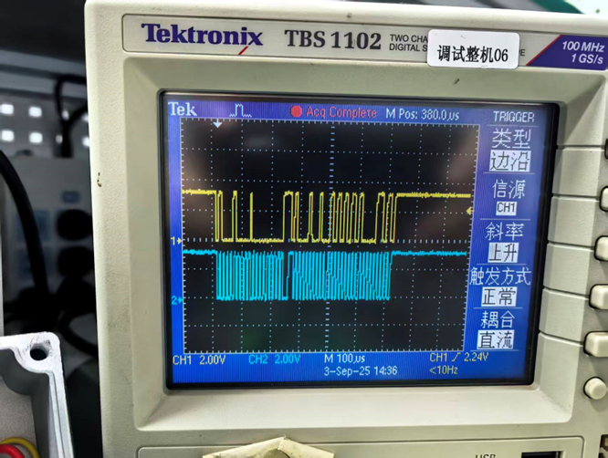

When the fault occurs, the I2C signal is measured, and the waveform obtained is as shown Figure 2.
Figure 2
The OPT3001 does not respond to the input signal, making it impossible for the application program to read valid data.

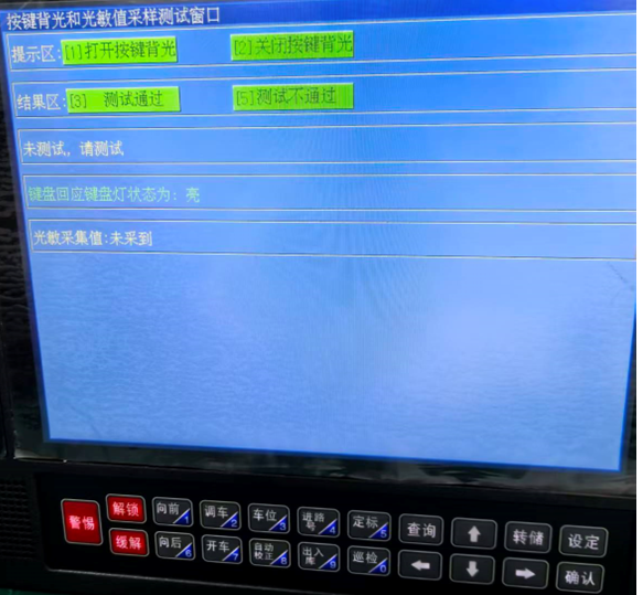

2.2 Overall Machine Measurement
When the backlight remains on abnormally, the test program fails to read the light sensor data, as shown in Figure 3:
Figure 3: Abnormal Backlight Constant On When Light Sensor Malfunctions
2.3 Power Supply and Waveform Measurement
Tests were conducted when the key backlight was on abnormally. Measurements showed that the CPU power supply and the light sensor power supply were normal; however, the software received no response when reconfiguring or reading data from the light sensor chip. After turning off the 3.3V power supply and turning it on again, the key backlight returned to normal. The measured abnormal waveform is shown in Figure 3. In contrast, under normal conditions, the light sensor chip responds properly to configuration and data reading commands, and the normal waveform is shown in Figure 4:
 Figure 4: Abnormal Waveform
Figure 5:Normal Waveform

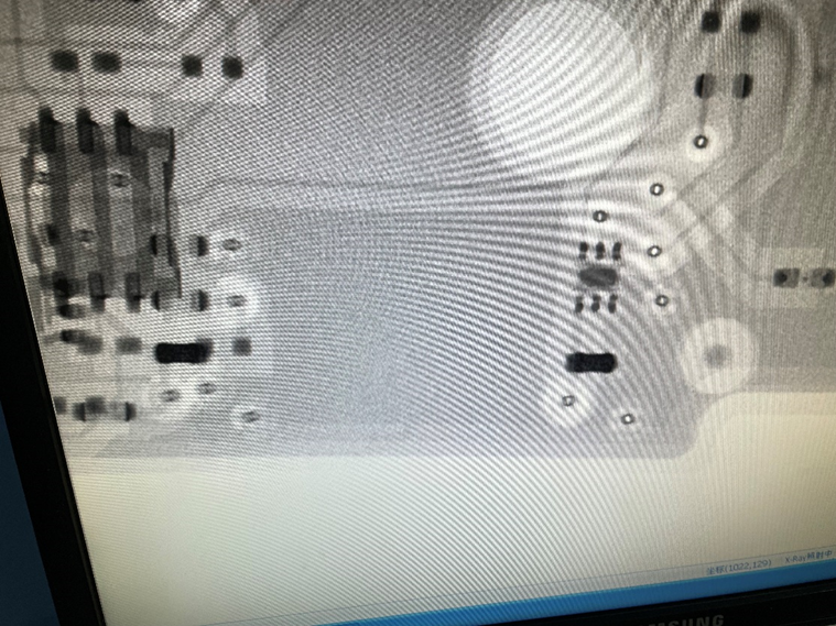

2.4 Chip Soldering Inspection
The soldering process of the light sensor (OPT3001DNPRQ1) was inspected, and no abnormalities were found. The reflow oven temperature profile was normal, with no obvious damage to the chip appearance, no internal wire breakage, and good soldering of the chip bottom and pins confirmed via X-ray inspection.
Electronic Magnifier Observation Image
X-ray Inspection Image of Pin and Bottom Soldering

    3、- have you scoped the address pin during start up to ensure it is truly at ground the full time?
    The Address Pin has not been measured with an oscilloscope; the OPT3001 can be accessed normally by powering it off and on again while keeping the CPU powered.
    TKS!!!
    If i'm understanding correctly this issue is occurring when whole system is being powered up, and from your response here it sounds like the OPT3001 will start up normally when power cycled while system is already up.  I have a suspicion that when the OPT3001 is brought up at same time as the system as a whole there may not be true ground at address pin at that moment and so config register is not being set successfully.
