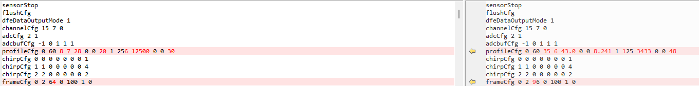

The only changes I made are highlighted in the image below.
Could you please review why this configuration does not work properly,
even though the rest of the parameters remain the same structure?
Thank you for your assistance.
Jaehoon Kim
  • Hello Jaehoon,
    Theres many reasons that changing only profileCfg and frameCfg can cause issues. I will note that the mmWaveSensingEstimator is not perfect and only covers timing paradoxes in the chart below when values are set in a way that is impossible to resolve.
    You can try changing aspects one at a time. Like one thing I see is you increased number of chirps to 96 and ADC samples to 125. You should keep these to power of 2s so you can try 128 and 128 rather than 64 and 256. Then work on timing aspects such as frequency slope, sample rate, idle time, etc.
