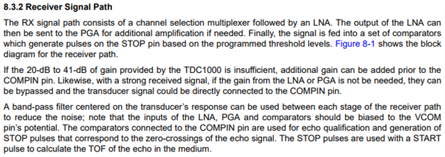

Yes, you can feed your signal directly to COMPIN pin if you already have a large enough signal level and don't require the LNA or PGA. See the receiver section of the datasheet below.

I am connecting my RF signal directly to the COMPIN pin instead of my RX pin, but the IC is unable to generate any STOP pulse. Kindly let me know if you need any schematic images or images of the RF signal which we are seeing on the Oscilloscope, Kindly reply ASAP.
Yes, can you please provide scope captures of the signal on the COMIN pin?
So this is the signal which I am connecting directly to my COMPIN pin I have not connected anything to my RX pin(therefore I am not using either amplifier) .
So now I am unable to generate any STOP pulse is it because I am not connecting anything to my RX pin because as far as I have read the STOP pulse is generated using the signal on the COMPIN pin it has nothing to do with the RX pin.
Kindly let me know how I should proceed.
Thanks.
Ritvik,
You can connect directly to the COMPIN pin, but the signal must be biased to VCOM(VDD/2). See the image below.
