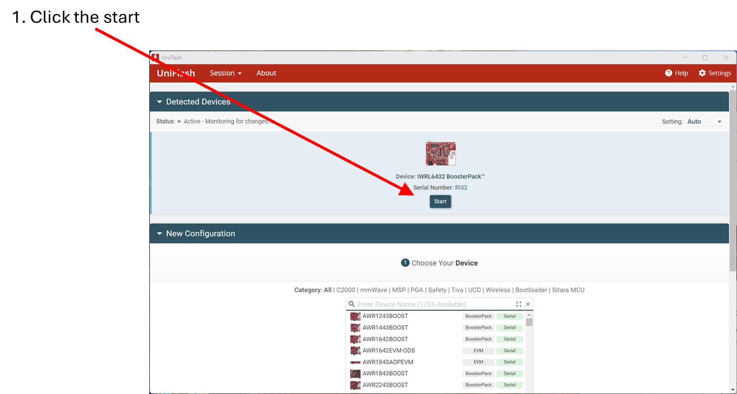

Hello TI community,
How can I modify the error(connect to xds110 failed) of TM4c1294ncpdtt335axx3w(xds110).
https://software-dl.ti.com/ccs/esd/documents/xdsdebugprobes/emu_xds110.html
https://e2e.ti.com/support/microcontrollers/arm-based-microcontrollers-group/arm-based-microcontrollers/f/arm-based-microcontrollers-forum/1374638/lp-am263p-xds-110-firmware-update-failure/5282507#5282507

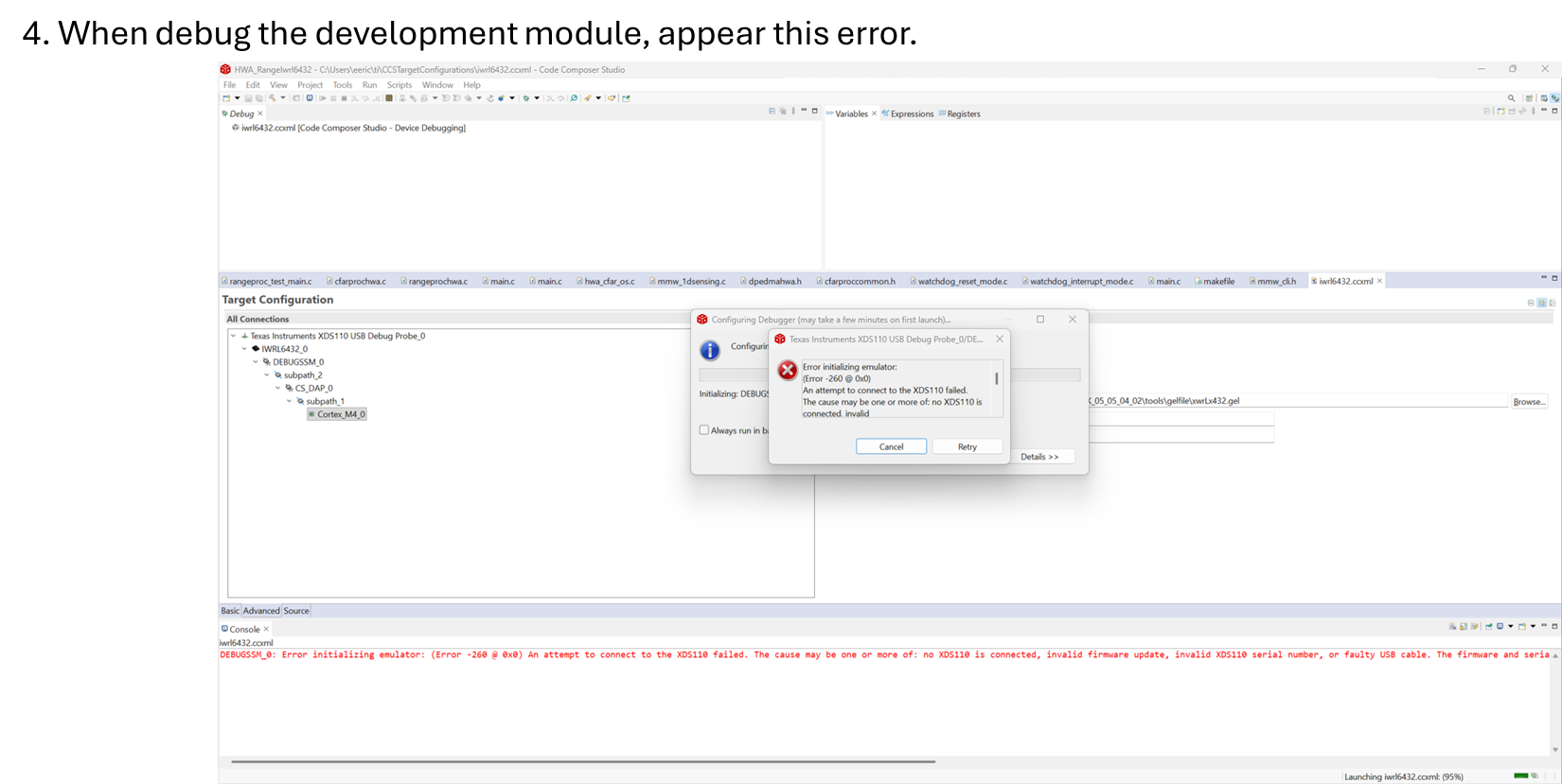

When I connect the mcu, appear this error.
Is
Serial Num:    NOserial result correct?
Cortex_M4_0: Trouble Halting Target CPU: (Error -1266 @ 0x0) Device is held in reset. Take the device out of reset, and retry the operation. (Emulation package 20.0.0.3178)

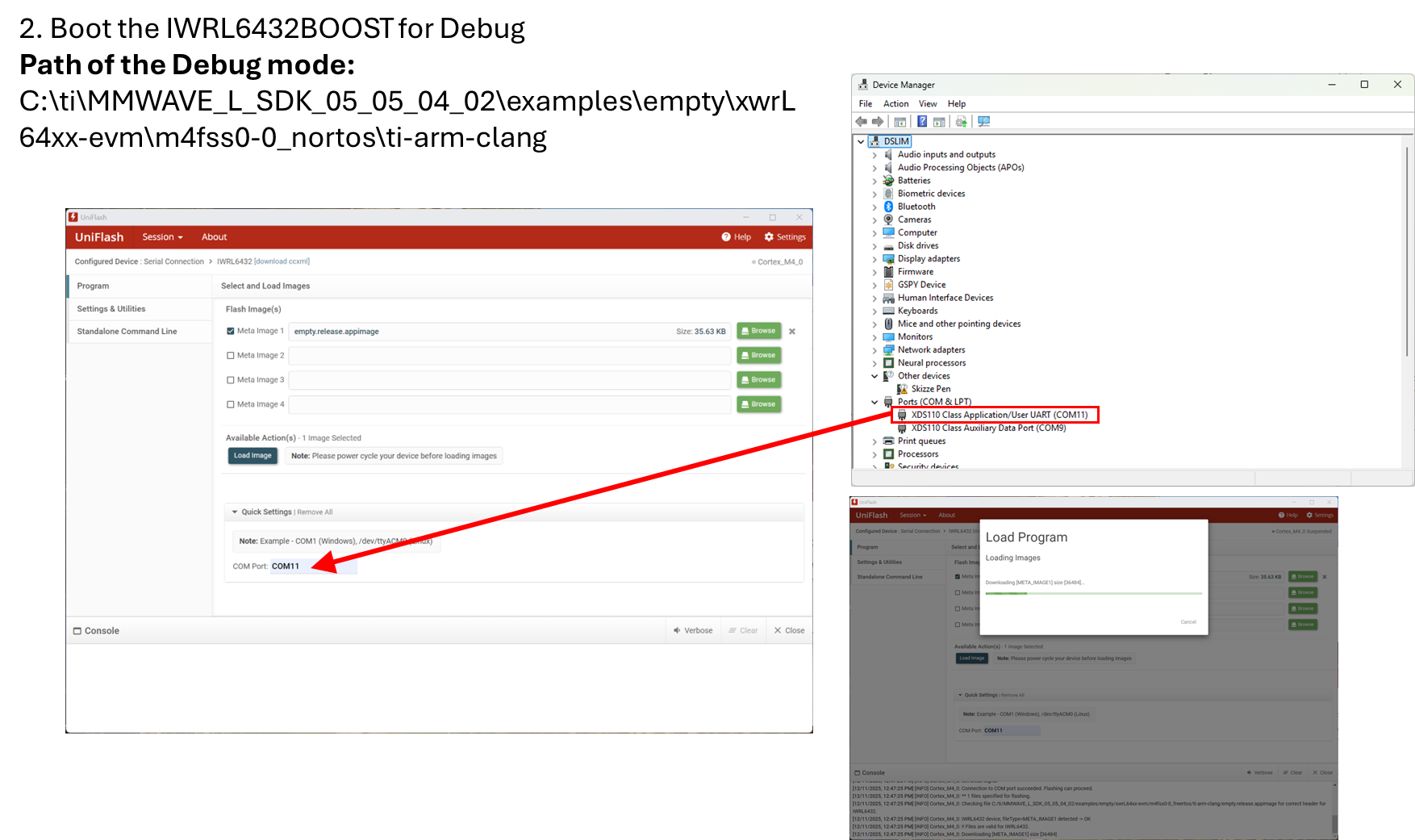

  • Hi Eric,
    The instructions for debugging can be found here: http://dev.ti.com/tirex/local?id=Debugging_with_older_CCS_versions&packageId=radar_toolbox

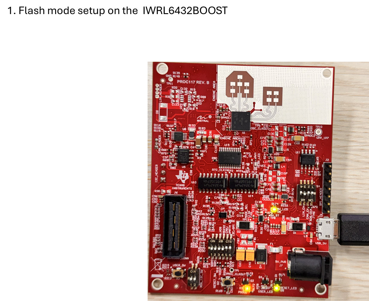

    Please let me know if something is unclear in the guide and I can try to clarify. However, I think I know what the issue is. Thank you for sharing all of the pictures and what you have shared, it is very helpful.
    I can see that you have the device placed in 'debug mode'. In truth this SOP mode may be a bit misleading because for debugging you should actually first flash the empty example appimage then enable 'functional mode' before connecting in CCS. Can you please try this to see if the issue is resolved?

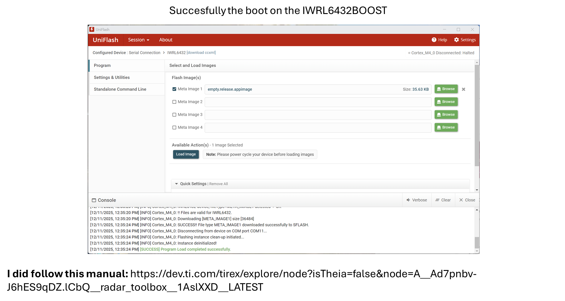

  • Hello Josh,
    I did try the functional mode, after booting the empty.appimage on the flash in flash mode.
    How can I modify this error.

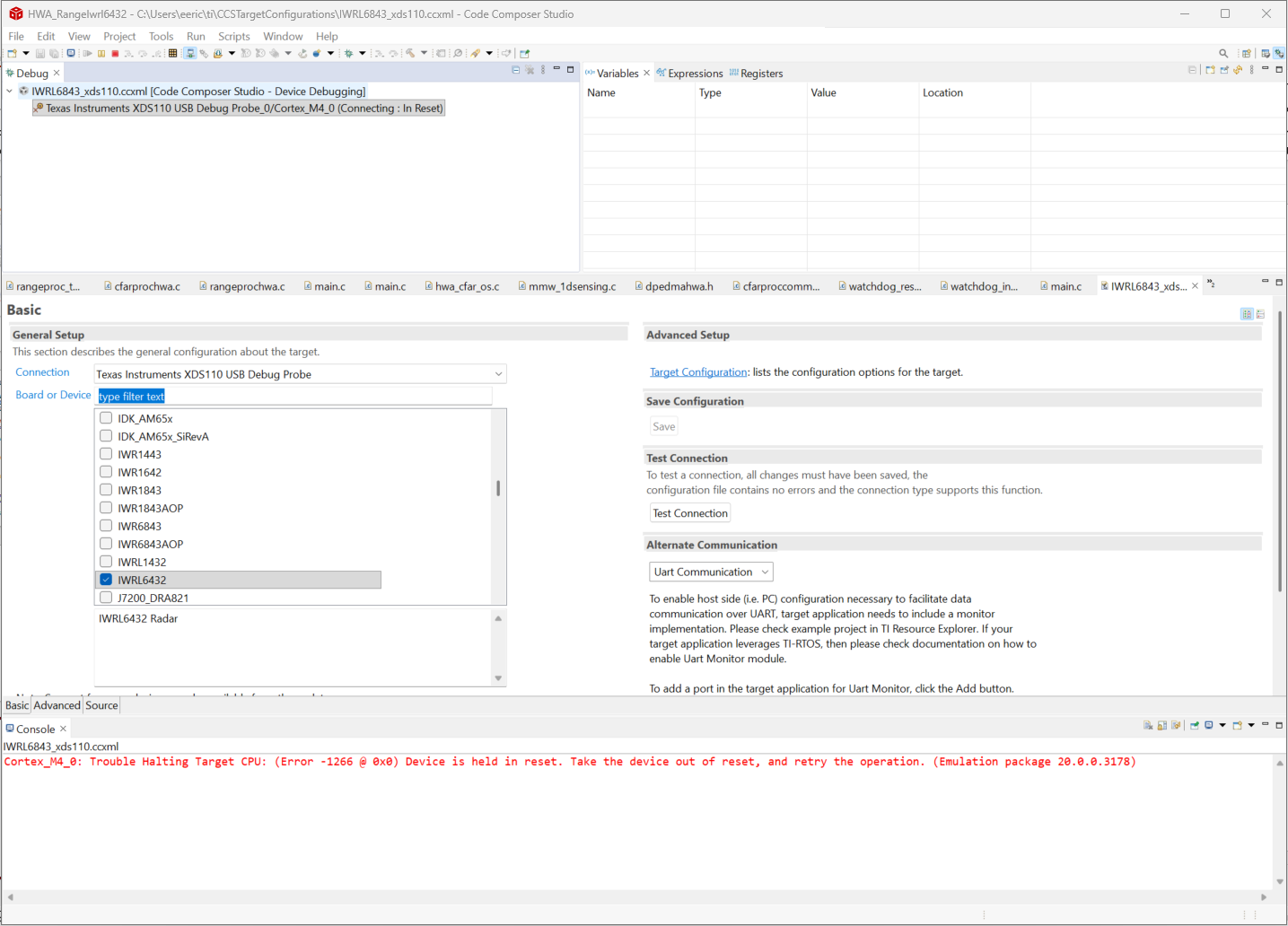

    Cortex_M4_0: Can't Run Target CPU: (Error -1268 @ 0x1090001) Device is locked up in Hard Fault or in NMI. Reset the device, and retry the operation. If error persists, confirm configuration, power-cycle the board, and/or try more reliable JTAG settings (e.g. lower TCLK). (Emulation package 20.0.0.3178)
    Eric.
  • Hi Eric,
    Understood. After the device is connected in CCS but before loading your program, can you first try pressing the CPU reset button in CCS? This is the icon (or Ctrl + Shift + R): .
    Josh
  • Hello Josh,
    Thanks for your feedback. It really helped me.
    Eric.
