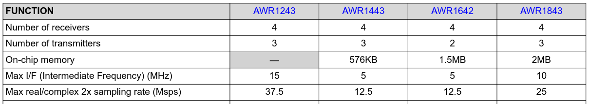

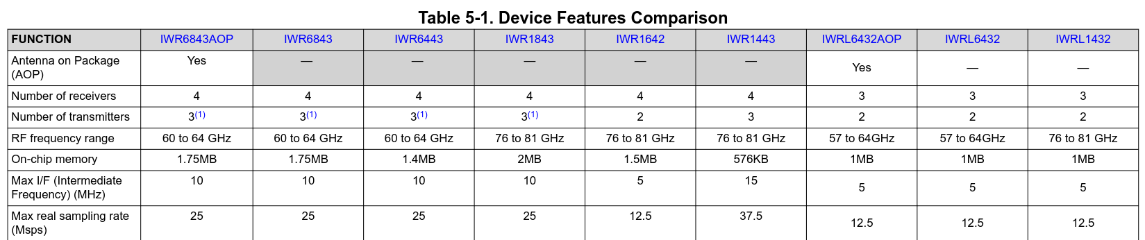

As far as I am aware, longer range performance requires higher transmit power and larger max IF. If I'm not wrong (please correct me if I am), the transmit power on the mmWave evaluation modules is generally not changing, so really it's about max IF. For this I look at the following comparison tables from IWR6843
and AWR1443:
This would lead me to believe either the IWR1443 or AWR1243 to be the best fit. Of course, I would assume the antenna design has an impact on this performance as well. For example, this antenna comparison:
claims it should instead be IWR1843BOOST. Does it make sense then that our best bet is the IWR1843BOOST?
One point of confusion: I thought that the AWR and IWR lines of the same board were functionally quite similar, but there are quite large differences here between IWR1443 and AWR1443. Maybe I am missing something?
