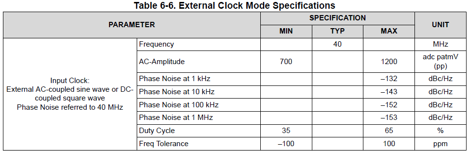

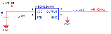

I'm trying to use an external oscillator instead of cystal in my AWR1843AOP board.
I can find the following in the datasheet of AWR1843AOP.
Can I directly connect the 1.8V square wave oscillator output to "CLKP"?
Or Should I add some RC Circuits to the oscillator output to make it look like a sine wave?
