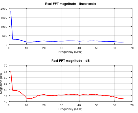

    I have done the collection of ADC data using the EVM board with these modifications made in the mmwave demo code. A strong target was kept at 4m and the range resolution is 0.456. Find the fft and phase plots attached below.
    Procedure followed:
    1) Capture the final chirp data sitting in the adc buffer using memory browser as the chirps overwrite in the same location and plot it using matlab to get the fft result.
    2) First send 1 frame of data with C0(+ve) C1(+ve) C2(-ve) C3(-ve) C4(+ve) C5(+ve) C6(-ve) C7(-ve) to get the negative chirp data sitting in the final buffer output. Then use "save memory" and plot the bin file to get the negative chirp data.
    3) Repeat this experiment with C0(-ve) C1(-ve) C2(+ve) C3(+ve) C4(-ve) C5(-ve) C6(+ve) C7(+ve) to get the positive slope chirp sitting in the memory browser.
    4) Plot the fft and phase plots found using [plot((imag(fft(adc_real,Nfft))));] of each of the chirps.

    1) These outputs do not seem conclusionary. What i am expecting is that the peak bin of both the negative and positive chirp should have the same magnitude but when we take the phase plot we should have a 180 degree phase shift due to the negative slope.
    2) Why is there an increase in the positive slope noise floor in the set 1 of case 1. And why are the rest of the configurations not even showing a peak in any of them? So does this imply that the understading of the chirp config being done nibble wise is correct? and if so, what is the order of configuration? Is it C1C0 and then C3C2 or the other way around.
    I hope this information helps, feel free to ask for more clarifications.
    I have also ensured that the param len is set correctly and have set the repeat count to 1 as shown below.
    Thank you once again for your help and assistance.

    Are you placing a strong corner reflector at the bore sight in a clean environment?  Do you see the peak in the range/Doppler FFT output associated with this corner reflector?
    Please can share the plots
    If BPM mode + slope switching does not make sense, can you also check the TDM mode.  You can magnitude square (non-coherently) combined the 2D FFT output from different antennas.
    Zigang
  • Hello Zigang,
    Thank you for your response. The plots for the range FFT output have come out good. I will attach it below. We can ignore the other peaks due to the testing environment having multi-path reflections.
    Now since the range fft output has come fine, but the individual chirps show the same plots with low amplitude. Upon further analysis, even talking the adc data without the LUT enabled shows the same low amplitude plots. So does this imply that since the range fft output with the LUT is showing a good plot, we can move forward that the +ve and -ve slope have been applied as given by the api?
    This range fft output is with BPM + slope switching. BPM enable was made as 0X20 for both the positive and negative chirps.
    Sincerely,
    Rohith Gopakumar
  • Hi, there:
    I assume this range FFT output plot is in dB, correct? The range FFT data looks good to me.  But you can calculate the Doppler FFT cross chirps off-line.  It will give you better noise floor information.
    Zigang
  • Hello Zigang,
    Thank you for your response. Yes the range output plot is in dB. Does this conclude that both with and without the LUT addition shows a low amplitude in the ADC plots for a single chirp but when we do the fft across multiple chirps and frames, the range fft output is good since we do the addition accross the chirps. And this is unrelated to the LUT addition?
    So are we safe to assume that the LUT config changes have taken place? thank you once again for your continued support and help. I will be closing the forum after this reply.
    Sincerely,
    Rohith Gopakumar
  • Hi, there:
    The range FFT data looks good to me.  It can also indicate the TX is enabled every chirp.  But again, you will need to go through the angle estimated step to fully convince that the TX/RX channel and BPM phase are programmed correctly.
    Zigang
