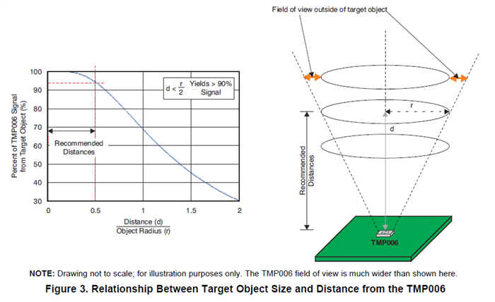

    Also if you can help me Ian in determining what is the distance beyond which TMP006 do not give proper results or what is the distance at which i can get maximum accurate temperature of solar panel. As of now I am placing the sensor as close as it can be to the solar panel, is it making any difference while measuring the temperature. Width, height & thickness of solar panel is 1318, 994 and 46 mm.

    The optimum distance is ≤ (1/2)*radius of a circular area of the object to be measured. For example, if you are interested in measuring a circular area of your solar panel which is 2 cm in radius, then the optimum distance of the TMP006 is 1cm away or less. There is no issue with placing the TMP006 closer. I've attached a screenshot from the TMP006 User's Guide which shows this.
