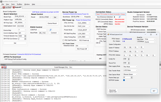

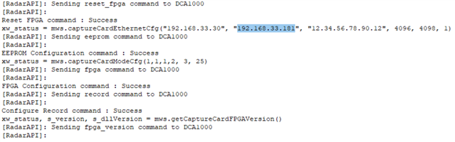

Hello TI team,

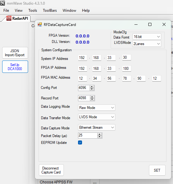

I follow the documentation SPRUIJ4A and test several configurations but I cannot change the ip address in the EEPROM. All the time the DCA1000 starts with ip from flash: 192.168.33.180.
I checked the switches also as the documentation says without success.
Is it possible to change the ip ?
We want to record data from 2 radars AWRL6844 at the same time. But, we are using 2 different laptops cause the ip cannot be changed.
Thanks in advance
