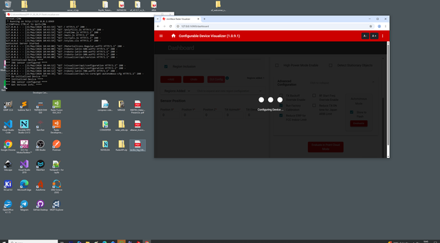

We recently purchased a BP-IWRL6432WMOD evaluation board to test the IWRL6432 radar, but unfortunately I haven’t been able to get it working.
I have tried using both the visualizer included with mmWaveuDFP-01_00_09_01 and the one from MMWAVE_L_SDK_05_05_04_02. I also installed the FTDI driver provided and carefully followed the setup instructions.
However, after pressing “Evaluate”, the process always gets stuck at the same point. The console shows:
“Get Version Info.”
and then the application hangs indefinitely.
I have tested this on two different computers with the same result.
Could you please help me identify what might be causing this issue?
Thank you.

    I flashed the image you provided using UniFlash, and according to the tool, the flashing process completed successfully.
    However, I am still experiencing the same issue. The visualizer gets stuck at the exact same point:
    *** Get Version Info. ****
    and does not continue any further.
    Thank you.

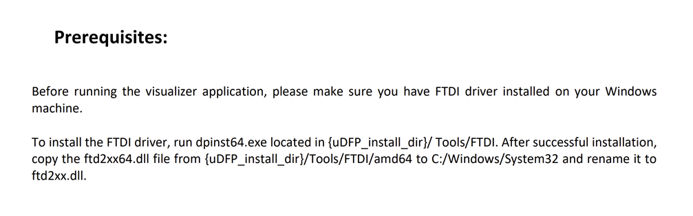

  • As i said, i installed the provided ftid driver replacing the dll as its on the product manual.

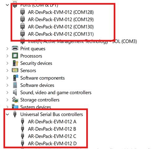

    Could you also provide the following information, it would help me in assisting you better:
    • Could you provide a snapshot of the Device Manager with the USB controllers and Ports expanded as given below?
    • Have you tried installing the FTDI drivers as given in the Visualizer User Guide? Attaching the snapshot below:

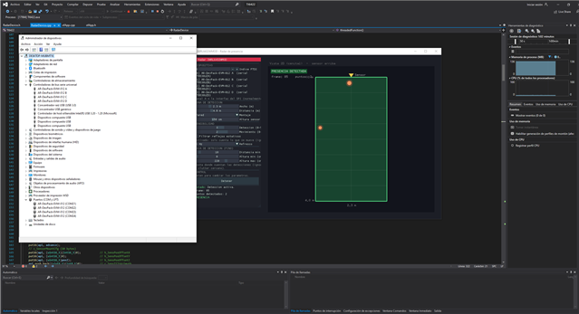

  • Hi
    As i said, yes presence works as presence led light up, also as i said i installed ftid drivers, replace dll.... etc etc etc.
    In fact i was able to make a fast app that can interact with the module.... however the visualizer dont work.
    With this we can assume board is flashed, drivers are ok.... etc etc. But visualizer dont
