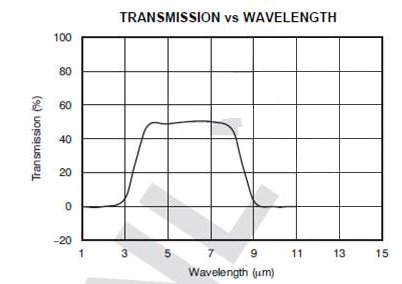

  3. What band in the IR is the sensor observing? We do other things with infrared light, and it will be very important for me to know exactly what frequencies will interfere with its operation and which will not.
      The TMP006 observes IR energy in the 4μm to 8μm band of the spectrum. I've attached the  transmission characteristic graph.
