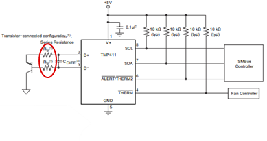

Per datasheet, a total of up to 3kΩ of series line resistance is cancelled. Is 3kΩ a combined series resistance connected externally to the D+, D– pins? Or is it a resistance connected externally to each of the D+, D– pins?

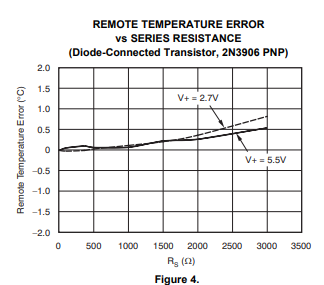

Hello Dung,
The series resistance cancelation is automatic within the device. I would try to not add any resistance to the D+ and D- lines. I have attached a plot of how resistance can affect the remote temperature error.

Hi Meredith,
Does that plot show the total resistance across the sensor path or per lead?
Dung Huynh
Hi Dung,
This plot is showing total resistance across D+ and D- lines.
