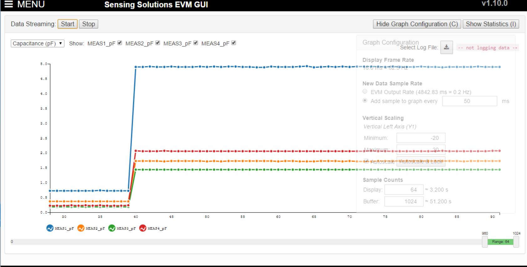

1) Data streaming does not work unless all 4 channels are enabled for reading. The settings are shown below, and data streaming has started, but no data has shown in the figure, and the corresponding CSV has no data.
2) This is my main problem. The plotting speed is too slow, so as the rate in the CSV. It seems that the  rate shown in the figure and CSV is around 5Hz, and I have selected the 400Hz sampling rate. No matter how I change the setting, the final rate is similar. My final aim is to have the sampling rate at least 30Hz.  I also show the corresponding settings below, you can check.

  • Hi Amanda,
    The result is the same. After configuring the device to sample only one channel at 100 Hz, the real sampling rate shown in the graph and the CSV is about 50 Hz. The settings are shown below, and as you can see in Figure 2, there are only around 500 counts in about 10 seconds.

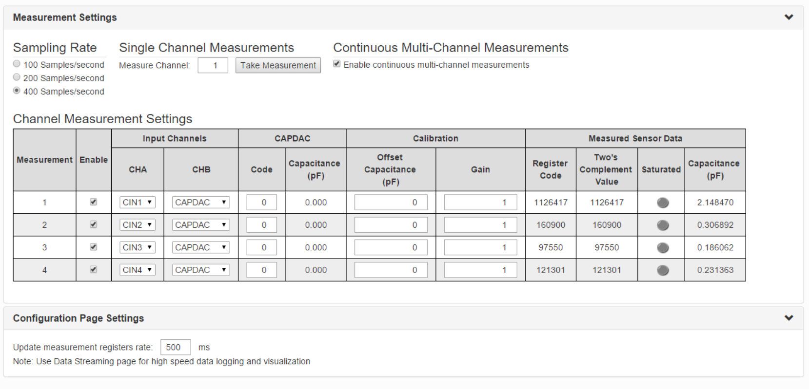

  • Hi Heng,
    Thank you for trying this. Can you please change the update measurement registers rate from 500 ms to to 10ms.
    Amanda
  • Hi Amanda,
    It seems that I can't change the update measurement registers rate to 10 ms, the minimum number is 100 ms. After changing to 100ms, the result is still the same.
