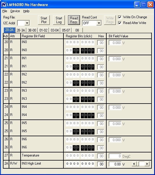

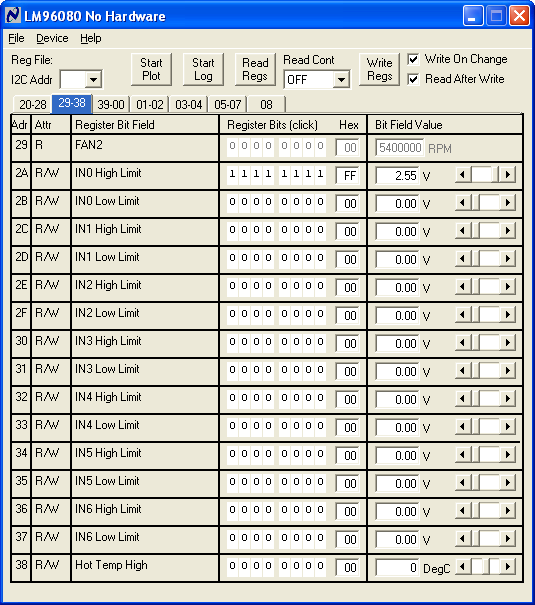

SensorEval software provides a very high level approach at experimenting with the basic read and write instructions. To be more specific, the data sheet
doesn't state the width for temperature or analog watchdog voltages (addresses 0h2A to 0h3B) ; I would assume the width is 10 bits like all analog input voltages in the same block , but I NEED to make SURE. To make things more confusing, SensorEval shows these values as being 8 bits? why!? Also, how many bits are considered in the comparison to set if a maximum has been violated?
