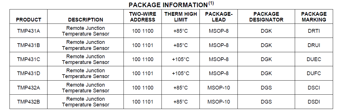

It appears that the  TMP431 temperature sensor does not fully support the SMBus interface specification. Specifically it doesn’t support address resolution protocol. (section 5.6 of SMBUS spec) http://smbus.org/specs/smbus20.pdf.
We are not able to  plug two or more cards without getting an address conflict.
Is this correct?
 If it is correct,  Is  the TMP431 has been updated recently to resolve this issue OR whether there is a very similar part that is a drop in replacement for this part that support the Address Resolution Protocol?
